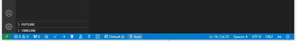

I noticed that for that problematic project, the IDE forces pio to use /dev/ttyUSB0
Executing task: platformio run --target upload --environment pico --upload-port /dev/ttyUSB0
while for the projects that work, the --upload-port is not used. Did I do something unknowingly in that project to force the port for ESP32? are there other places than platform.ini to force the upload port?
