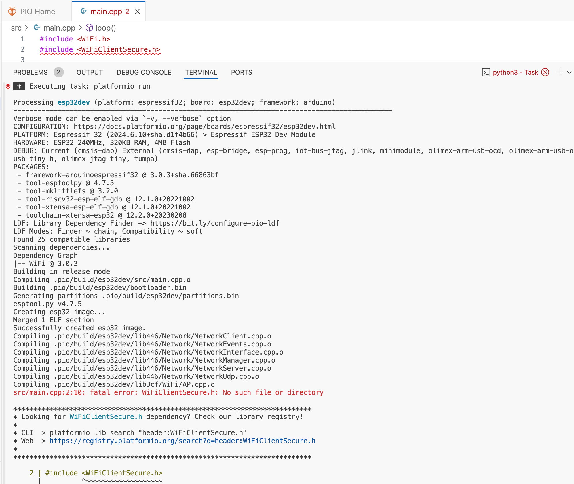

Cannot open source file "WifiClientSecure.h"
I have a piece of code in VSCode using the Platform IO extension. It is being copied straight from the Arduino IDE where it worked.
#include <WiFi.h>
#include <WiFiClientSecure.h>
WiFiClientSecure wifiClient = WiFiClientSecure();
void setup()
void loop()
  delay(1000);

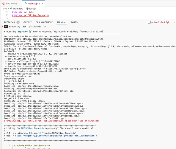

This code does not compile; the error shown is:
src/main.cpp:2:10: fatal error: WiFiClientSecure.h: No such file or directory
The platformio.ini contents are:
platform = https://github.com/Jason2866/platform-espressif32.git#Arduino/IDF5
Is there a way to make the code above compile (while keeping the same platform.io)?

That did not work.
i.e. removing ~/.platformio and restarting VSCode yielded the same error
(I also tried using the new name NetworkClientSecure.h ; same result)
