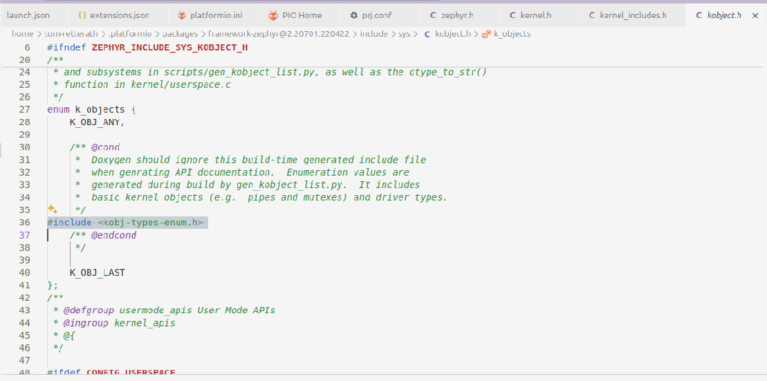

Hello, im trying the tutorial from Valerii Koval and im having difficulties building it. I followed the steps and tried to compile it, but it seems im missing a header file named kobj-types-enum.h. Here is the error message:
 *  Executing task: platformio run --environment nrf52840_dk
Processing nrf52840_dk (platform: nordicnrf52; board: nrf52840_dk; framework: zephyr)
CONFIGURATION: https://docs.platformio.org/page/boards/nordicnrf52/nrf52840_dk.html
PLATFORM: Nordic nRF52 (10.7.0) > Nordic nRF52840-DK
HARDWARE: NRF52840 64MHz, 256KB RAM, 1MB Flash
DEBUG: Current (jlink) On-board (cmsis-dap, jlink) External (blackmagic, stlink)
 - framework-zephyr @ 2.20701.220422 (2.7.1)
 - tool-cmake @ 3.21.3
 - tool-dtc @ 1.4.7
 - tool-gperf @ 3.0.4
 - tool-ninja @ 1.7.1
 - tool-sreccat @ 1.164.0 (1.64)
 - toolchain-gccarmnoneeabi @ 1.80201.181220 (8.2.1)
Reading CMake configuration...
Parsing system calls...
Generating syscall files
Generating KObject files...
Traceback (most recent call last):
  File "/home/tom/.platformio/packages/framework-zephyr@2.20701.220422/scripts/gen_kobject_list.py", line 60, in <module>
    from distutils.version import LooseVersion
ModuleNotFoundError: No module named 'distutils'
*** Error 1
Validating driver...
*** Error 1
Found 0 compatible libraries
No dependencies
Compiling .pio/build/nrf52840_dk/offsets/zephyr/arch/arm/core/offsets/offsets.c.o
In file included from /home/tom/.platformio/packages/framework-zephyr@2.20701.220422/include/kernel_includes.h:41,
                 from /home/tom/.platformio/packages/framework-zephyr@2.20701.220422/include/kernel.h:17,
                 from /home/tom/.platformio/packages/framework-zephyr@2.20701.220422/arch/arm/core/offsets/offsets_aarch32.c:28,
                 from /home/tom/.platformio/packages/framework-zephyr@2.20701.220422/arch/arm/core/offsets/offsets.c:9:
/home/tom/.platformio/packages/framework-zephyr@2.20701.220422/include/sys/kobject.h:36:10: fatal error: kobj-types-enum.h: No such file or directory
* Looking for kobj-types-enum.h dependency? Check our library registry!
* CLI  > platformio lib search "header:kobj-types-enum.h"
* Web  > https://registry.platformio.org/search?q=header:%1B%5Bm%1B%5BKkobj-types-enum.h
 #include <kobj-types-enum.h>
compilation terminated.
Compiling .pio/build/nrf52840_dk/zephyr_final/zephyr/misc/empty_file.c.o
*** [.pio/build/nrf52840_dk/offsets/zephyr/arch/arm/core/offsets/offsets.c.o] Error 1
====================================================================== [FAILED] Took 9.76 seconds ======================================================================
 *  The terminal process "platformio 'run', '--environment', 'nrf52840_dk'" terminated with exit code: 1.

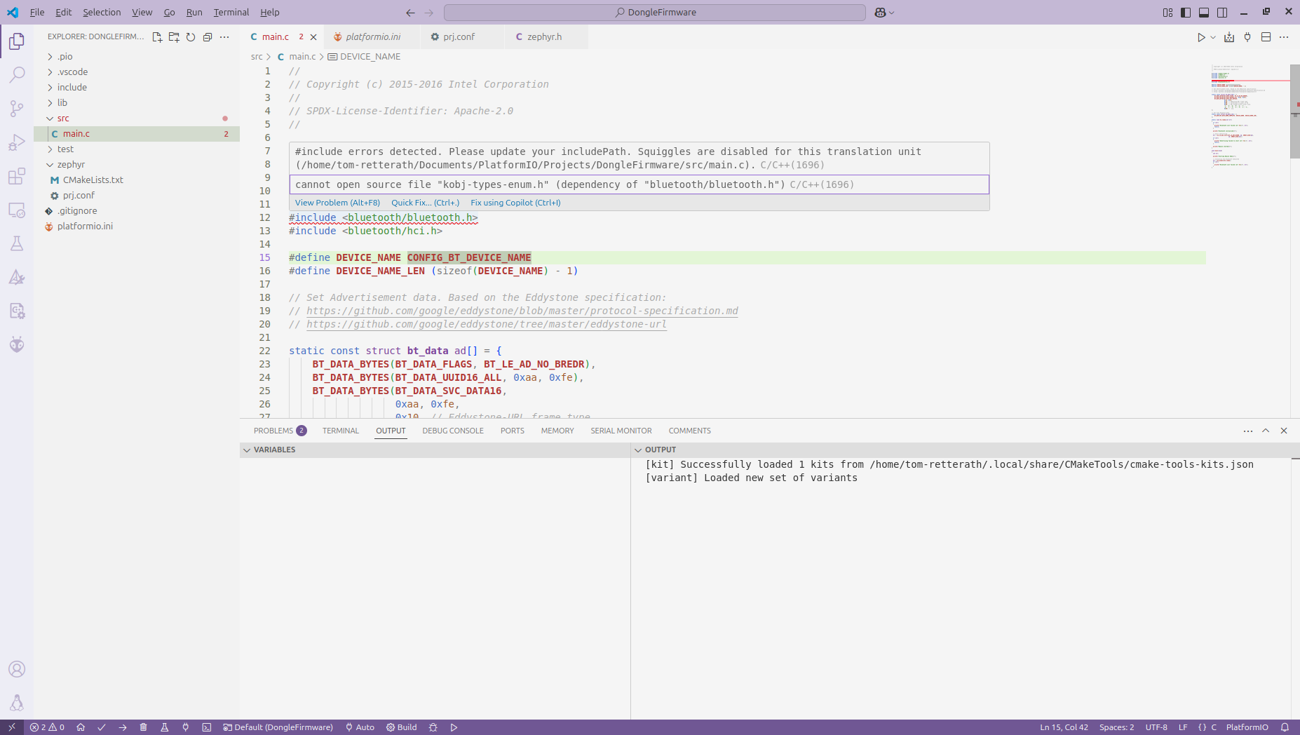

Does this happen with a clean PlatformIO installation?
rm -rf /home/tom/.platformio
and restart VSCode and try again.
I removed it. Running this inside the /home returns nothing tom@tom-hs-pc:~$ ls -la | grep ".platformio"
Relaunching VS Code caused it to install the packages anew and update the indexes. It also showed a message about not findint the CMake files and VS Code wanted me to select a kit, but this solved itself automatically and it uses now the /home/tom/.local/share/CMakeTools/ :
    "name": "GCC 13.3.0 x86_64-linux-gnu",
    "compilers": {
      "C": "/usr/bin/gcc",
      "CXX": "/usr/bin/g++"
    "isTrusted": true
It also loaded the new variants ([variant] Loaded new set of variants) (whatever those are).
It took a long time “Updating metadata for the vscode IDE” but still, the package is missing.
Deactivate the Makefile and CMake extension when working with PltaformIO projects. Then restart VSCode. Delete the .vscode folder if needed.

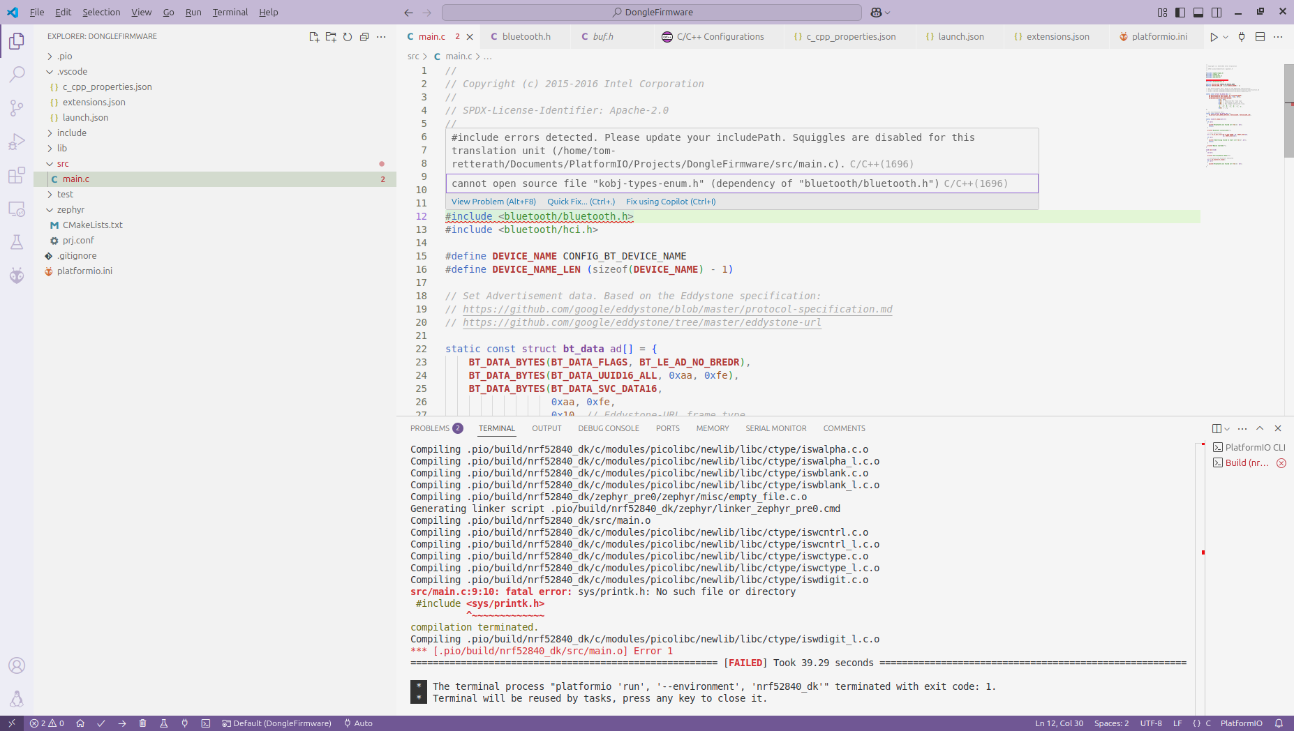

Removed .vscode and disabled those extensions. Relaunching VS Code caused this output:
Resolving nrf52840_dk dependencies...
Already up-to-date.
Updating metadata for the vscode IDE...
UserSideException: Processing nrf52840_dk (platform: nordicnrf52; board: nrf52840_dk; framework: zephyr)
 - framework-zephyr @ 3.40000.0 (4.0.0)
 - tool-dtc @ 1.4.7
Installing `mbedtls` project
Cloning into '/home/tom-retterath/.platformio/packages/framework-zephyr/_pio/modules/crypto/mbedtls'...
HEAD is now at a78176c6f Merge pull request #63 from tomi-font/bump_to_3.6.2
Installing `mcuboot` project
Cloning into '/home/tom-retterath/.platformio/packages/framework-zephyr/_pio/bootloader/mcuboot'...
HEAD is now at f74b77cf imgtool: fix signing for fix-sig-pubkey public rsa
Installing `mipi-sys-t` project
Cloning into '/home/tom-retterath/.platformio/packages/framework-zephyr/_pio/modules/debug/mipi-sys-t'...
HEAD is now at 71ace1f mipi_syst: fix build error when having protocol timestamp disabled
Installing `open-amp` project
Cloning into '/home/tom-retterath/.platformio/packages/framework-zephyr/_pio/modules/lib/open-amp'...
HEAD is now at b735edb lib: remoteproc: replace strncpy with internal strlcpy
Installing `openthread` project
Cloning into '/home/tom-retterath/.platformio/packages/framework-zephyr/_pio/modules/lib/openthread'...
Updating files:  84% (3282/3889)
Updating files:  85% (3306/3889)
Updating files:  86% (3345/3889)
Updating files:  87% (3384/3889)
Updating files:  88% (3423/3889)
Updating files:  89% (3462/3889)
Updating files:  90% (3501/3889)
Updating files:  91% (3539/3889)
Updating files:  92% (3578/3889)
Updating files:  93% (3617/3889)
Updating files:  94% (3656/3889)
Updating files:  95% (3695/3889)
Updating files:  96% (3734/3889)
Updating files:  97% (3773/3889)
Updating files:  98% (3812/3889)
Updating files:  99% (3851/3889)
Updating files: 100% (3889/3889)
Updating files: 100% (3889/3889), done.
HEAD is now at 2aeb8b833 [mle] prioritize equivalent pending dataset update over MLE announce (#10631)
Installing `percepio` project
Cloning into '/home/tom-retterath/.platformio/packages/framework-zephyr/_pio/modules/debug/percepio'...
HEAD is now at b68d179 Merge branch 'main' into zephyr
Installing `picolibc` project
Cloning into '/home/tom-retterath/.platformio/packages/framework-zephyr/_pio/modules/lib/picolibc'...
HEAD is now at d492d5fa7 cmake: Guard CMAKE_BUILD_TYPE when integrating with Zephyr
Installing `segger` project
Cloning into '/home/tom-retterath/.platformio/packages/framework-zephyr/_pio/modules/debug/segger'...
HEAD is now at 798f95e config: SEGGER_RTT_Conf: remove mutex locking
Installing `tinycrypt` project
Cloning into '/home/tom-retterath/.platformio/packages/framework-zephyr/_pio/modules/crypto/tinycrypt'...
HEAD is now at 1012a3e Fix warnings reported by UBSAN
Installing `uoscore-uedhoc` project
Cloning into '/home/tom-retterath/.platformio/packages/framework-zephyr/_pio/modules/lib/uoscore-uedhoc'...
HEAD is now at 84ef879 Merge pull request #4 from rlubos/upmerge-06-06-24
Installing `zcbor` project
Cloning into '/home/tom-retterath/.platformio/packages/framework-zephyr/_pio/modules/lib/zcbor'...
HEAD is now at 47f34dd Update version to 0.9.0
-- Application: /home/tom-retterath/Documents/PlatformIO/Projects/DongleFirmware/zephyr
-- CMake version: 3.21.3
-- Found Python3: /home/tom-retterath/.platformio/penv/.zephyr-4.0.0/bin/python (found suitable version "3.12.3", minimum required is "3.10") found components: Interpreter
-- Cache files will be written to: /home/tom-retterath/.cache/zephyr
-- Zephyr version: 4.0.0 (/home/tom-retterath/.platformio/packages/framework-zephyr), build: zephyr-v40000
-- Board: nrf52840dk, qualifiers: nrf52840
-- Found toolchain: gnuarmemb (/home/tom-retterath/.platformio/packages/toolchain-gccarmnoneeabi)
-- Found Dtc: /home/tom-retterath/.platformio/packages/tool-dtc/dtc (found suitable version "1.4.7", minimum required is "1.4.6")
-- Found BOARD.dts: /home/tom-retterath/.platformio/packages/framework-zephyr/boards/nordic/nrf52840dk/nrf52840dk_nrf52840.dts
-- Generated zephyr.dts: /home/tom-retterath/Documents/PlatformIO/Projects/DongleFirmware/.pio/build/nrf52840_dk/zephyr/zephyr.dts
-- Generated pickled edt: /home/tom-retterath/Documents/PlatformIO/Projects/DongleFirmware/.pio/build/nrf52840_dk/zephyr/edt.pickle
-- Generated devicetree_generated.h: /home/tom-retterath/Documents/PlatformIO/Projects/DongleFirmware/.pio/build/nrf52840_dk/zephyr/include/generated/zephyr/devicetree_generated.h
-- Including generated dts.cmake file: /home/tom-retterath/Documents/PlatformIO/Projects/DongleFirmware/.pio/build/nrf52840_dk/zephyr/dts.cmake
Parsing /home/tom-retterath/.platformio/packages/framework-zephyr/Kconfig
Loaded configuration '/home/tom-retterath/.platformio/packages/framework-zephyr/boards/nordic/nrf52840dk/nrf52840dk_nrf52840_defconfig'
Merged configuration '/home/tom-retterath/Documents/PlatformIO/Projects/DongleFirmware/zephyr/prj.conf'
-- Configuring incomplete, errors occurred!

First i commented out, which didnt work at all. But now i have a different error because of a missing file sys/printk.h. I added the .vscode folder back and got the same warning message as earlier:

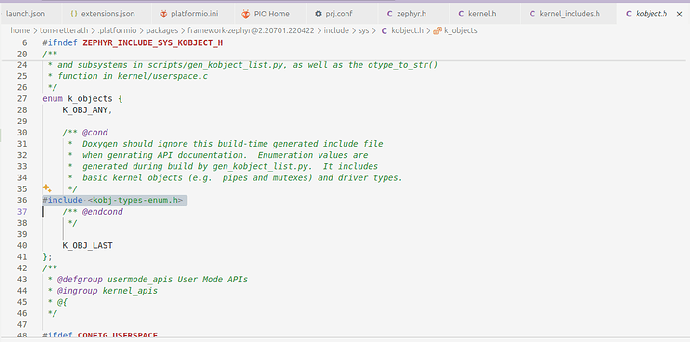

However, when i build, i got the missing sys/printk.h. Confusing. It is there, but the kobj-types-enum.h is missing.
I tracked it down to the kobject.h:

No, i still get dependency errors:

src/main.c:7:11: fatal error: zephyr.h: No such file or directory
* Looking for zephyr.h dependency? Check our library registry!
* CLI  > platformio lib search "header:zephyr.h"
* Web  > https://registry.platformio.org/search?q=header:%1B%5Bm%1B%5BKzephyr.h
  #include <zephyr.h>

This is very frustrating lol. Could it be that the c_cpp_properties.json is wrong? :
// !!! WARNING !!! AUTO-GENERATED FILE!
// PLEASE DO NOT MODIFY IT AND USE "platformio.ini":
// https://docs.platformio.org/page/projectconf/section_env_build.html#build-flags

Ok, everything fails?? It still relies on this distutils package. I will downgrade Python from 3.12->3.9 on antother machine and try this there.

Okay, this is definitely the source of the problem, but I don’t know why it won’t be installed.
Building the reference blinky works just fine for me.

No, this still doesnt work. I see that you have Python 3.11.7, while i have Python 3.12.3:
python3 --version
Python 3.12.3
The output is still depending on this distutils:
  File "/home/tom-retterath/.platformio/packages/framework-zephyr@2.20701.220422/scripts/gen_kobject_list.py", line 60, in <module>
*** Error 1
*** Error 1
No dependencies
In file included from /home/tom-retterath/.platformio/packages/framework-zephyr@2.20701.220422/include/kernel_includes.h:41,
                 from /home/tom-retterath/.platformio/packages/framework-zephyr@2.20701.220422/include/kernel.h:17,
                 from /home/tom-retterath/.platformio/packages/framework-zephyr@2.20701.220422/arch/arm/core/offsets/offsets_aarch32.c:28,
                 from /home/tom-retterath/.platformio/packages/framework-zephyr@2.20701.220422/arch/arm/core/offsets/offsets.c:9:
/home/tom-retterath/.platformio/packages/framework-zephyr@2.20701.220422/include/sys/kobject.h:36:10: fatal error: kobj-types-enum.h: No such file or directory

Can you, in that same CLI, do
/home/tom-retterath/.platformio/penv/bin/python -m pip install setuptools
and clean recompile (delete .pio folder and build again)
Edit: It says here that distutils was removed in favor of setuptools, exactly starting at Python version 3.12: https://stackoverflow.com/a/76691103/5296568
So my Python 3.11 version may as well be the reason.
CC @ivankravets I have reason to believe that
  1. PlatformIO core installer installs Python 3.12
  2. Zephyr depends on distutils which was previously present in Python 3.11, but with Python 3.12 was removed in favor of the setuptools package
  3. setuptools package is by default not installed
  4. nRF52 CI does not catch this because it still works on Python 3.9
  5. Hence building Zephyr project with the Python 3.12 enviornment does not seem to be possible without workarounds (installing setuptools package)
