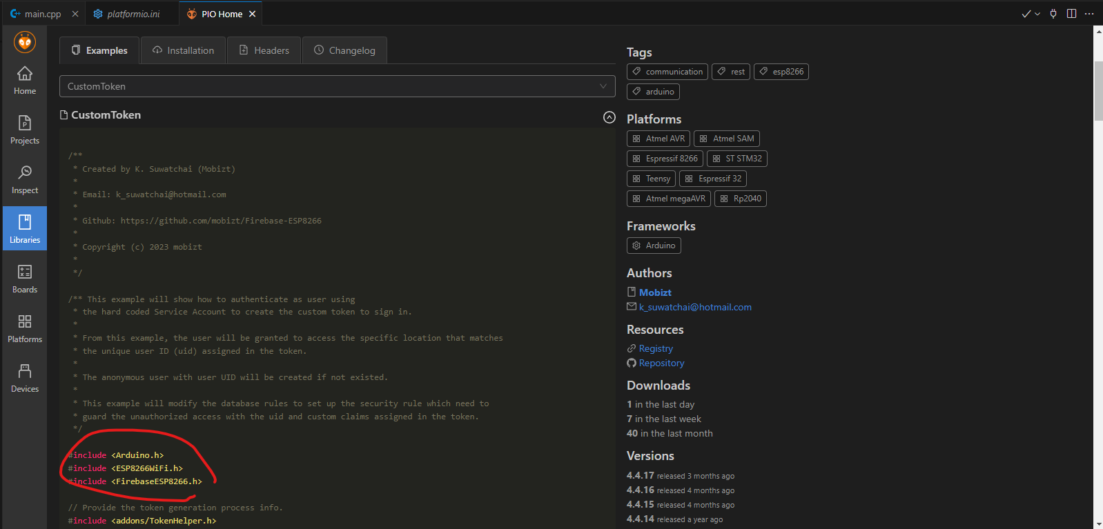

Hi, I have this problem when using firebaseESP8266. I doubled check the library installed in platformio.ini, it was there. If I use Arduino IDE with the same library, it’s no problem. I am using ESP8266.
#include errors detected. Please update your includePath. Squiggles are disabled for this translation unit (E:\Documents\PlatformIO\Projects\ivbagnode\src\main.cpp).C/C++(1696)
cannot open source file "FirebaseESP8266.h"C/C++(1696)

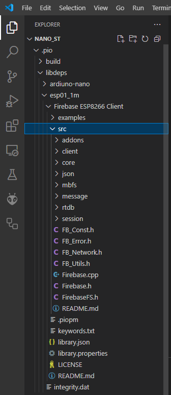

Does the file .pio\libdeps\esp01_1m\Firebase ESP8266 Client\src\FirebaseESP8266.h exist?
Very interesting.
The library version it downloads, there is no FirebaseESP8266.h in it.
But, per https://github.com/mobizt/Firebase-ESP8266/blob/v4.4.17/src/FirebaseESP8266.h the file should exist inversion 4.4.17.
The file just redirects to #include "Firebase.h" though.
SUCCESS! Thank you so much for spoting this.
I renamed to Firebase.h and it succeeded to build.
This is a bit confusing though since it has no error in the Arduino IDE. The code in the examples it given from library is not updated I guess? Because I was just following the examples.

This… shouldn’t happen. The author must have uploaded a custom version of the library for the file to not be there. It exists in the tagged github version, so why not in the PlatformIO registry?
You should be able to use your original code if you pull the library dependency from the github tag too:
https://github.com/mobizt/Firebase-ESP8266/archive/refs/tags/v4.4.17.zip
