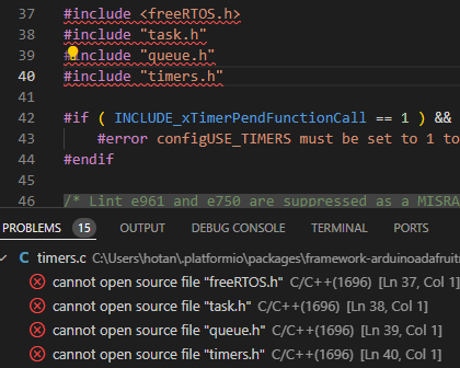

Hi, I am trying to fix these problems from \.platformio\packages\framework-arduinoadafruitnrf52\cores\nRF5\freertos\Source.
I have try several ways to fix them like removing .platformio\packages\framework-arduinoespressif32 because it maybe got messed up but not work.
Then I added
lib_deps = feilipu/FreeRTOS into platform.ini
After that, add #include <avr/io.h> into ‘main.cpp’ and ‘timers.c’ but it is not working.
Then I replace ‘#Include <Arduino_FreeRTOS.h>’ with ‘#Include <freeRTOS.h>’ and then not work.
Even include “main.h” and include “imu.h” into main.cpp. Not work at all.

Finally, how can I fix <cannot open source file “freeRTOS.h” , “task.h” , “queue.h” , “timers.h” from timers.c>? Are there any mistakes during the ways I tried?

Intellisense in the core files being unresolved may just be a visual bug. Does the project compile ? The Adafruit nRF52 core should have FreeRTOS builtin. feilipu/FreeRTOS should definitely be removed from lib_deps. What’s the compile error then?

Where is the board definition for wiscore_rak4631? This seems to be a custom board.
That screenshot still shows that it’s trying to use the FreeRTOS configuration from .libdeps, aka the feilipu library. Delete the whole .pio folder of the project and build again for a clean build.

It’s still using that feilipu/FreeRTOS library. Are you sure you’ve deleted it from lib_deps, saved the platformio.ini and deleted the .pio folder?

I can build this firmware just fine.
With only
[env:wiscore_rak4631]
platform = nordicnrf52
board = wiscore_rak4631
as my platformio.ini and installing the RAK boards via https://github.com/RAKWireless/WisBlock/blob/master/PlatformIO/RAK_PATCH.zip .
Also intellisense works fine.
Did you add the framework-arduinoadafruitnrf52 folder to the VSCode workspace maybe? If so, you must also copy the .vscode folder from the firmware project to framework-arduinoadafruitnrf52 for intellisense to work correctly.
