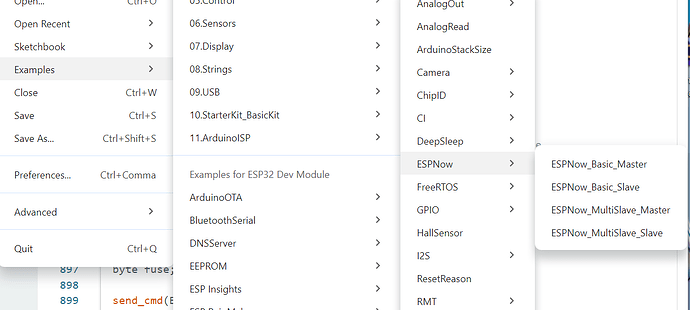

I cannot find ESPNow in the examples and Search only tells me to select from list.
So is the Arduino build in examples also available in PlaformIO?
I assume you’re referring to the Arduino framework - If not, please specify exactly which examples you mean.
The Arduino based examples are available since Espressif Arduino 3.x
So you might need to switch from Arduino 2.x to Arduino 3.x which can be done by using the community fork pioarduino:
Thanks , I refer to this examples , ArduinoIDE.
I was looking at the wrong place in PlatformIO.
I can add ESPNow in the Libraries section , PlatformIO , this will work for now.
