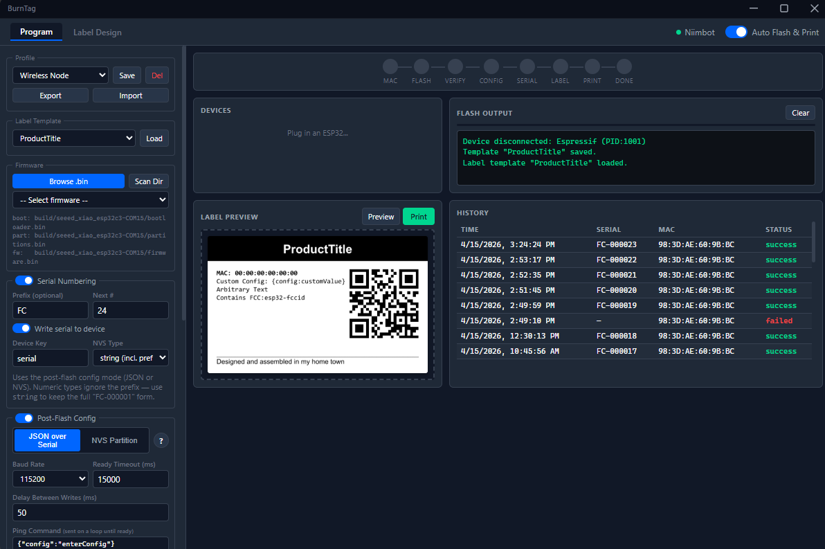

This software can auto flash ESP32 devices when connected, and extract the MAC address to print on the label, as well as send custom per device configurations to the device with verification after imaging.
Example. I use these wireless nodes, and I’m able to print the nodeIDs on the labels, and have it auto increment the number after each success, and auto print a label. I also print the FCC ids, and other information.
You can also include a QR code, and if you want include the custom information into the qr code thats generated for each print.
The labels are customizable in an editor. I could only post one image as a new user so see the imaging screen below, and download to see the label customization screen.

Below is the programming screen which auto recognizes and programs esp32 as they are plugged in (or manually with auto turned off). To use the after imaging config you can use either a JSON config, or write direct to NVS partition. JSON is what I use, where the device accepts an {“config”:”enterConfig”} which responds with {“status”:”ok”} then accepts other configs like {“config”:”nodeId”:5}
Its very customizable. You can set custom response verification as well. You can use custom serial numbering as well.
