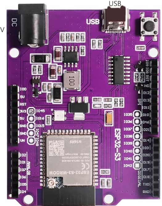

or witch board could I use for a
APKLVSR ESP32-S3 Entwicklung Bord,ESP32 S3 WROOM-1-N16R8 Board.
could be find on Amazon. looks like a UNO
regards
Jörg
