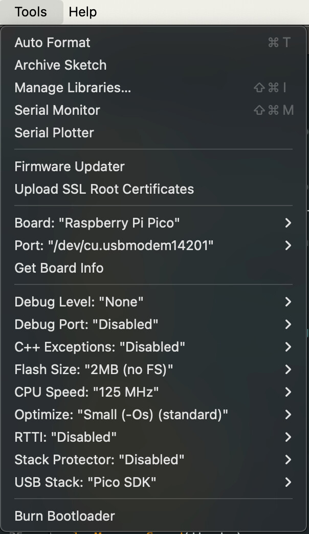

When I build a project and upload it to Thumby (RP2040), I get Success in the terminal, while on Thumby I only see a black screen and nothing happens.
What I get with Arduino IDE build: working code like expected
PlatformIO build: black screen and nothing happens, no code running I guess.
Arduino IDE Settings

This log shows
/Users/john/Library/Arduino15/packages/rp2040/hardware/rp2040/2.2.1
which would indicate that in the Arduino IDE, you’re using Arduino-Pico 2.2.1 from June 2022
https://github.com/earlephilhower/arduino-pico/releases/tag/2.2.1
While PlatformIO uses pretty much 3.2.2. That’s a major difference in core version.
Can you check in the Arduino IDE’s board manager whether you really have 2.2.1 installed for the Pico core?
When you update to the latest stable 3.2.2 core in the Arduino IDE, does the code still work?
