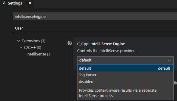

Do you set a different value for C_Cpp.intelliSenseEngine on the global or workspace level? (Ctrl+Shift+P → Open Settings UI)
grafik
Did you set a different value for C_Cpp.intelliSenseEngine on the global or workspace level?
Ah, yes I did. I had disabled the IntelliSense engine in my user settings :man_facepalming:
