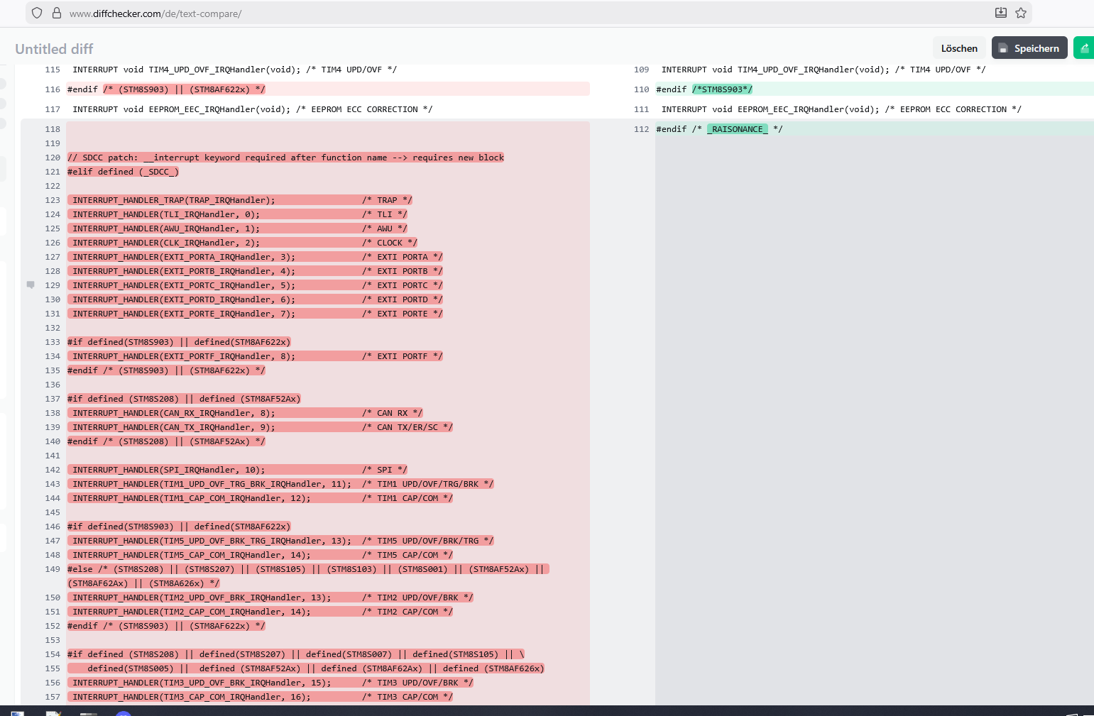

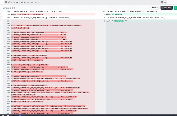

You didn’t copy stm8s_it.h from the original example correctly. (original source). Large blocks of code are just missing in regards to handling SDCC. Could it be that you let some tool autogenerate this code, which was meant to be for a totally different compiler?
I actually tested the original https://github.com/platformio/platform-ststm8/blob/develop/examples/spl-uart-simple-printf example on Linux, without any modifications regarding the toolchain etc., and it built fine.

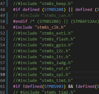

Ok, I changed that file as you advised, but faced a new error:

This is due to your stm8s_conf.h now. All includes for all subsystems were activated. SDCC is very poor at producing optimized code and doing link-time-optimization and dead code elimination. PlatformIO has an optimization that the C files from the SDK are not compiled in if their respective header file is not activated in the stm8s_conf.h (see platform code). Again, if you take the code exactly from https://github.com/platformio/platform-ststm8/blob/develop/examples/spl-uart-simple-printf/src/stm8s_conf.h, it compiles fine.

Yeah, I’ve changed stm8s_conf.h, and my code was built successfully! But why is such a large size for a UART working? If we compare it with Arduino IDE + Mini Pro MCU, all flash size fits in 1 KB. Where is an advantage here?
