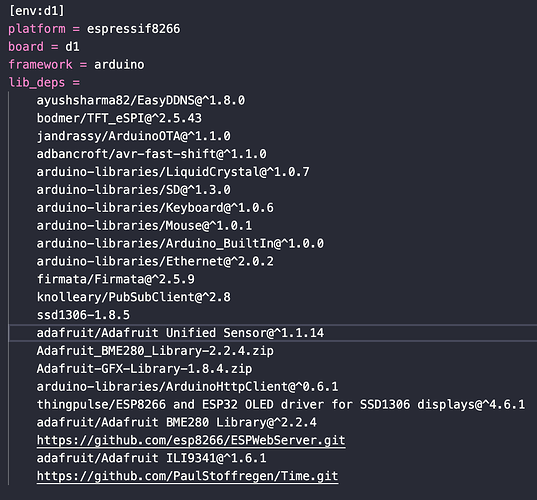

Please show the content of your platformio.ini

But your lib_deps lists a lot of thirdparty libraries which are not compatible to the ESP8266 and have builtin counterparts. Those libraries must be removed from the lib_deps.
Unfortunately I’m unable to edit n screenshot.
Please post file content and logs as pre-formatted text next time.
Remove all unnecessary libraries like
jandrassy/ARduinoOTA (a builtin library is available!)
Nearly all “arduino-libraries/…” are not compatible to the ESP8266 and should be removed. If there is no builtin library available, look for a thirdparty library at the registry or on github for an ESP8266 compatible library.
SD is a builtin library
Keyboard → not supported by ESP8266
Mouse → not supported by ESP8266
Ethernet → not needed! You’re using wifi…
I’ve got the feeliing that the whole project was not meant to run on an ESP8266 ?
You’ll find the builtin libraries on your harddrive in %HOMEPATH%/.platformio/packages/framework-arduinoespressif8266/libraries
The corresponding github repository is GitHub - esp8266/Arduino: ESP8266 core for Arduino
After my post I was wonder if text would be better, so here it is. When I started this project I might have had more confusion about libraries so I probably added some that aren’t applicable, as you pointed out. I’m running code on Wemos D1 mini which is an ESP8266 device.
[env:d1]
platform = espressif8266
board = d1
ayushsharma82/EasyDDNS@^1.8.0
bodmer/TFT_eSPI@^2.5.43
jandrassy/ArduinoOTA@^1.1.0
adbancroft/avr-fast-shift@^1.1.0
arduino-libraries/LiquidCrystal@^1.0.7
arduino-libraries/SD@^1.3.0
arduino-libraries/Keyboard@^1.0.6
arduino-libraries/Mouse@^1.0.1
arduino-libraries/Arduino_BuiltIn@^1.0.0
arduino-libraries/Ethernet@^2.0.2
firmata/Firmata@^2.5.9
knolleary/PubSubClient@^2.8
ssd1306-1.8.5
adafruit/Adafruit Unified Sensor@^1.1.14
Adafruit_BME280_Library-2.2.4.zip
Adafruit-GFX-Library-1.8.4.zip
arduino-libraries/ArduinoHttpClient@^0.6.1
thingpulse/ESP8266 and ESP32 OLED driver for SSD1306 displays@^4.6.1
adafruit/Adafruit BME280 Library@^2.2.4
adafruit/Adafruit ILI9341@^1.6.1

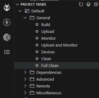

Then perform a “Full Clean”:
PIO-Icon / Project Tasks / Default / General / Full Clean:
