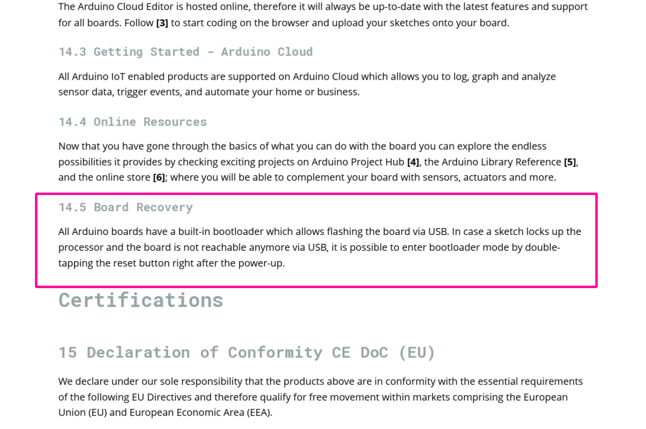

Have you tried the steps in section 14.5 of the ABX00083 manual?
(I have attached a screenshot for your reference.)
