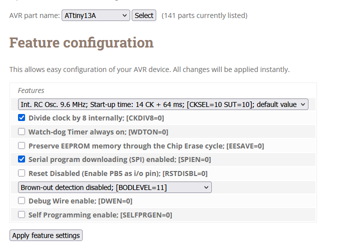

Please post your platformio.ini as well as the hex values of the LOW and HIGH fuse of your ATTiny13A. You can read them out via avrdude. Do you use an external clock for the ATTiny13A?
If a wanted delay of 1000ms turns into 20ms, then the microcontroller runs about 50 times faster than the code expects. This can be a problem with the selected clock source and the divide by 8 setting.
