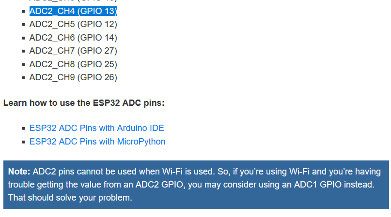

How? You can’t use an ADC2 pin while the WiFi is operating.
https://randomnerdtutorials.com/esp32-pinout-reference-gpios/
Thanks for the reference, it’s indeed seems the issue :pray:
