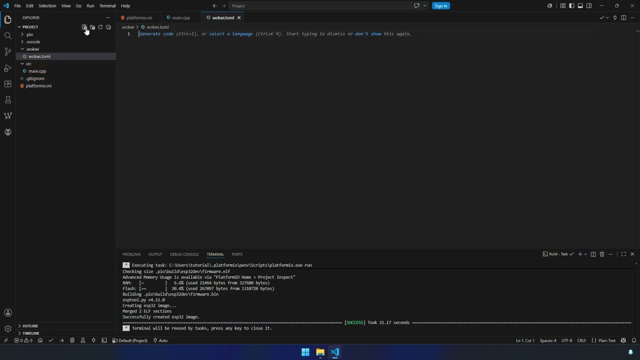

After today’s VS Code update Pioarduino which is not installed shows in PlatformIO exactly as in this screenshot and I can’t anymore create a new ESP32-S3 project.
