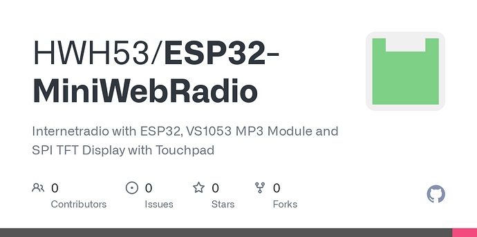

Please post the link to your fork of the project
Here is the Link:
It is only the native fork. The problem starts when open the Code in VSCode and it’s self configuring.
thanks for your assistance
Helmut

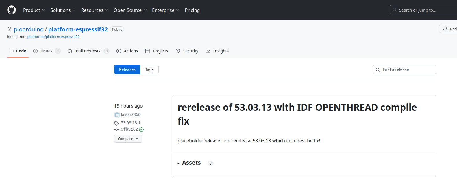

the Problem is fixed by the Projectowner. Problem was corupted files in “pioarduino”.
;platform = https://github.com/pioarduino/platform-espressif32/archive/refs/tags/54.03.20-rc2.zip ; Arduino 3.2.0 IDF 5.4.0 - is broken
;platform = https://github.com/pioarduino/platform-espressif32/releases/download/54.03.20/platform-espressif32.zip ; Arduino 3.2.0 IDF 5.4.1 - is broken
platform = https://github.com/pioarduino/platform-espressif32/releases/download/53.03.13-1/platform-espressif32.zip ; Arduino 3.1.3 IDF 5.3.2
With my last Chat i don’t recognize that the Problem was fixed by the Projectowner.
My misunderstanding was the time that my Linux was crashed and new installed. Then the Error came up and i knew that the function was correct before.
Thanks for your assistance!!!

Hallo Jason2866,
i’ll think it was a broken pioarduino release. Look at my screenshot from the GitHub pioarduino page:
After this change, thru the projectowner, it compiles as before my fatal systemcrash.
