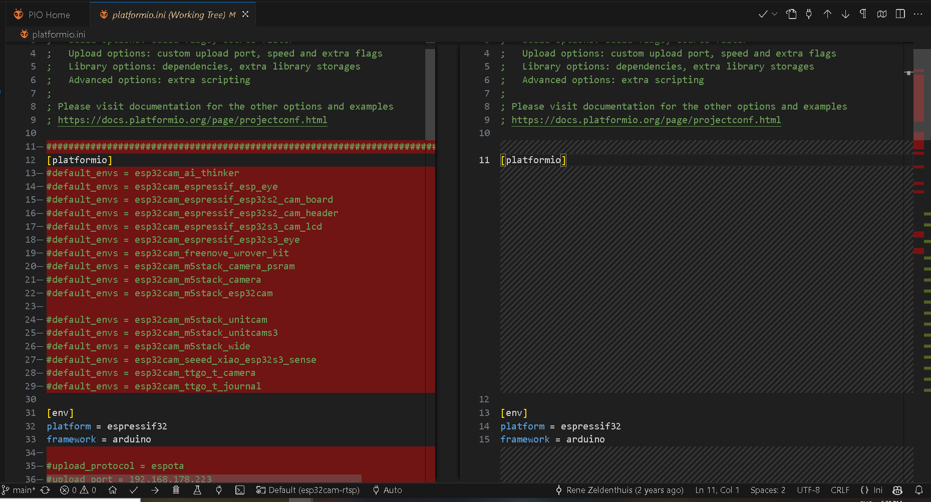

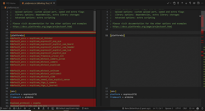

trying to modify a firmware for an esp-cam. cloneing git, fresh download builds fine. but when i add another library it stops building and starts throwing errors about missing files for things that werent a problem the moment before, and i havnt even changed anything else. it appears that adding the library does a number on the platformio.ini file, including deleting a BUNCH of commented lines and its confusing and frustrating that i dont understand WHY it would do that or how to revert whatever it does.

if you want to try and reproduce, i forked GitHub - rzeldent/esp32cam-rtsp: Simple RTSP (streaming image) server for the ESP32CAM. Easy configuration and monitoring through the web interface. and tried to add ps4 host controller something: GitHub - pablomarquez76/PS4_Controller_Host: Allows ESP32 to communicate with PS4 controller (can be used to control robots and other devices). after adding it starts throwing errors about missing ov2460 and IoTWebConf among others, all things that are very much part of the original file. LDF sounds extremely relevant, ill look into that, thank you
so after starting over in another partition (in case i was having space issues again) i tried again, and instead of using the gui>platformio>libraries>search>add to project(which resulted in the near destruction of the platformio.ini), i just added the single line to lib_deps. seems to work, will find out for sure as i add the rest of the functionality

ha! im running windows 10. from what i could tell it was adding a new line for every board enviroment to include the dependency, and deleting every commented line. i think it also either deleted or moved other lines that were important? im honestly not sure, just that building failed and once i manually added the single line everything works, at least as far as platformio goes, it doesnt look like the library is going to play nice with the camera, but thats for a different forum

so at least lines commented out by #
