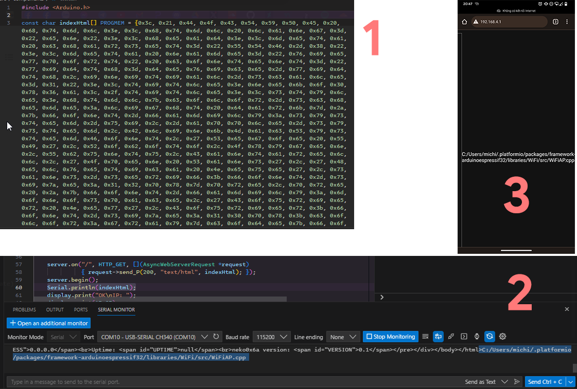

I have a C array like this. (Image 1)
But after I compiled, why is this string automatically appended to my string? (Image 2)
C:/Users/michi/.platformio/packages/framework-arduinoespressif32/libraries/WiFi/src/WiFiAP.cpp
It has broken my HTML content (Image 3)

const char indexHtml[] PROGMEM = {
6d, 0x6c, 0x3e};
array is declared to be of const char [], aka a C-string, but it fails to have a zero-terminator at the end of the array. This is not automatically added in the array.
So, the Serial.println(const char*) function just prints data starting at the pointer you give it until it encounters a null-byte (the zero terminator). Since you have none in your array, it goes beyond its bounds and prints whatever happens to be after the array until it does hit a zero byte.
Simply add a 0x00 as the last element of the array to make it valid C-string.
Otherewise, you could have also called the Serial.println() overload that takes a pointer and length, that is
// does not print beyond bounds
Serial.println((const uint8_t*) indexHtml, sizeof(indexHtml));
