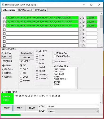

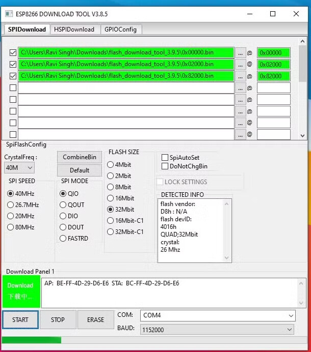

Note that htis is not the graphical “Flash Download tool”, but you can still flash your firmware using this esptool.exe tool on the commandline. When you have settings like
This should translate into a command like
esptool.exe -bm qio -bz 32M -bf 40 -cp COM4 -cb 115200 -cf 0x0000.bin -ca 0x0000 -cf 0x02000.bin -ca 0x02000 -cf 0x82000.bin -ca 0x82000
