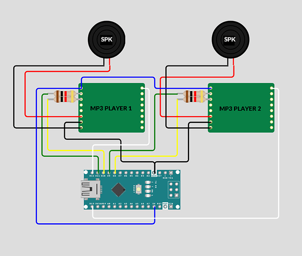

I have 2 DFmini MP3 players attached to one Nano. This is not my first MP3 project, but the first with 2 players.
I can only get one or the other to play when I don’t start the other one.
Both players will start and return the message that they have started, and the two “delay loops” will run. When the sketch reaches the point where it is to play the selected file, the sketch locks up.
If I start only one player and run only its respective “delay loop,” that player will play.
As you can see in the attached code,
I have included the libraries “SoftwareSerial.h” and “DFRobotDFPlayerMini.h” and
I have declared two different players and SoftwareSerial serials.
I have resistors (1K) on both the TX and RX pins. This is something I have always done with my mp3 projects. It might be overkill, but it works for me.
I use the “busy pin” of the player to get feedback from the player. I have tried commenting that part out, and the sketch still locks up.
Here is my wiring diagram.

Here is an example of the serial monitor output when both players are started up. The sketch stops at line 67

This may be a limitation from the software serial libray. There can only be one active serial object at a time. In places where you use e.g. MySerial_2,
you should first MySerial_1.end(), and vice-versa.
I believe that you are correct about the limitation of a library, but it appears that the library DFRobotDFPlayerMini.h cannot handle multiple players. At least, I cannot find a way to make it work and not the softwareSerial library.
Doing some searching on the www, I came across a similar problem but not truly the same, and in that problem, the user was using this library DFPlayerMini_Fast.h.
I tried
  1. Adding the DFPlayerMini_Fast.h to the project and assigning the Mp3Player2 to be an object of DFPlayerMini_Fast.
DFPlayerMini_Fast Mp3Player2;
After commenting out some of the players startup commands used by DFRobotDFPlayerMini.h e.g.
  • Mp3Player1.setTimeOut(500);
  • Mp3Player1.outputDevice(DFPLAYER_DEVICE_SD);
The sketch worked as I was hoping it would. :smiley:
  1. I then did the same to Mp3Player1, and again the sketch worked as I was hoping it would. :smiley::smiley:
    I have removed the DFRobotDFPlayerMini.h library from the project,
Thank you for your suggestions and for putting up with my ignorance.
