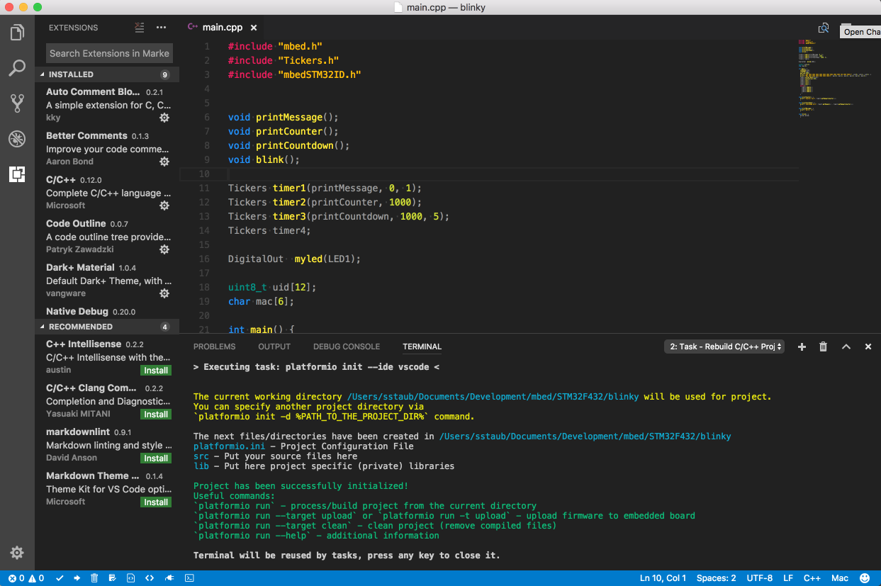

Rebuild C/C++ gives following output:
It looks like it makes init instead of rebuild
That is correct command
