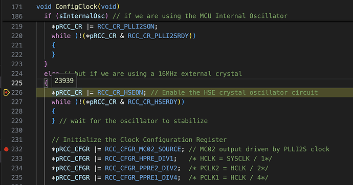

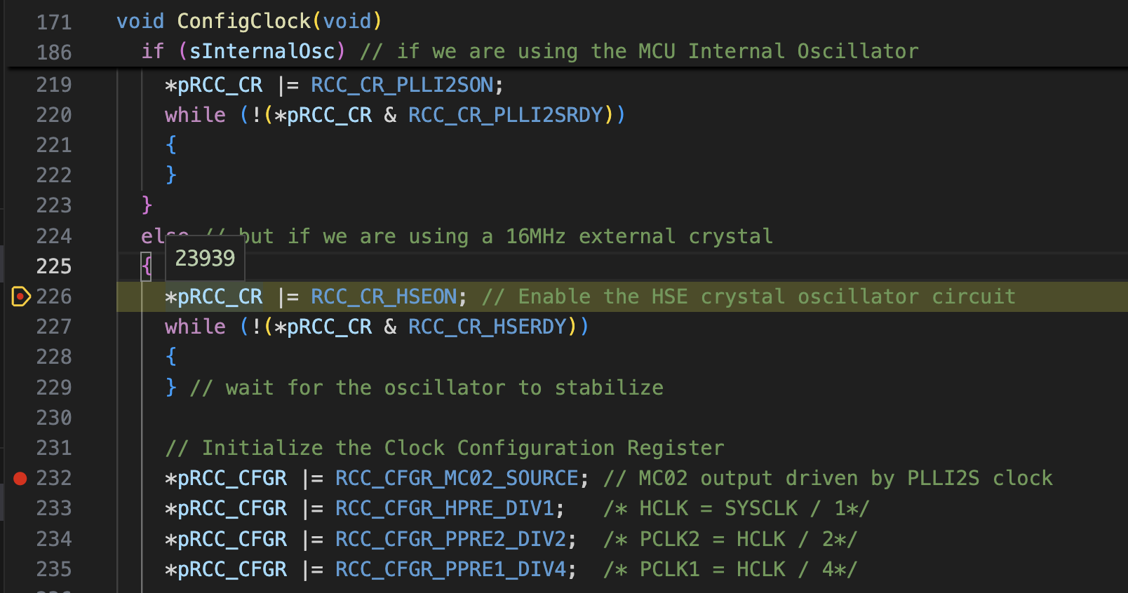

@maxgerhardt, I thought you might be interested in a few observations that I made while analyzing the optimization issue in a bit more detail.
I used the original setting: debug_build_flags = -Os -ggdb2 -g2
At the first breakpoint the value in RCC is x5D83 (23939) (how can I make the debugger display hex?)

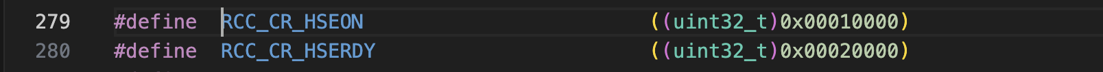

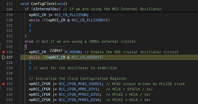

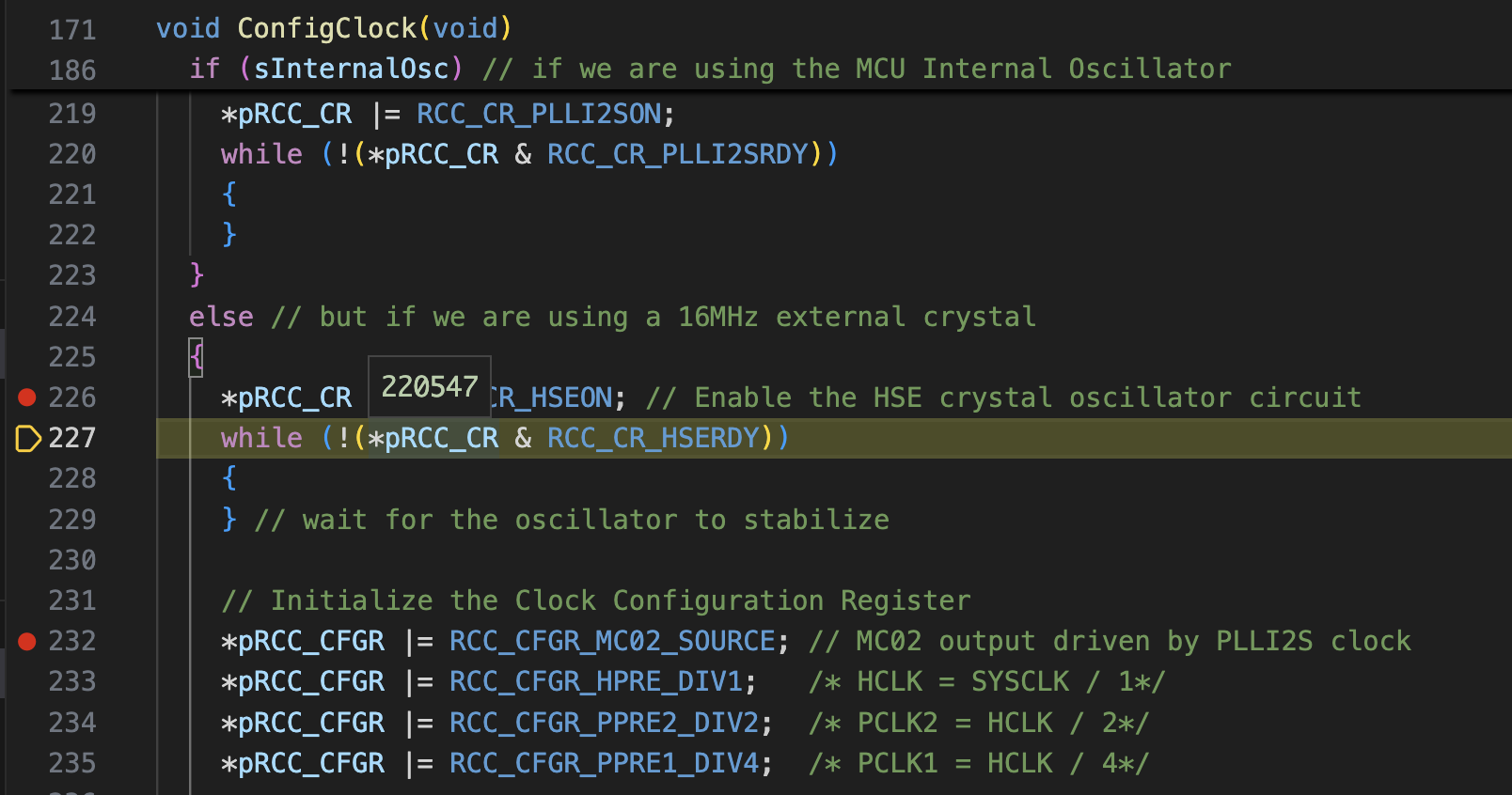

Then after single-step to the next line the value in RCC has changed to x35D83 (220547). Clearly two bits have been set, namely the bits defined by:
However, at this point if I push the RUN button, the behavior is that of an infinite loop.

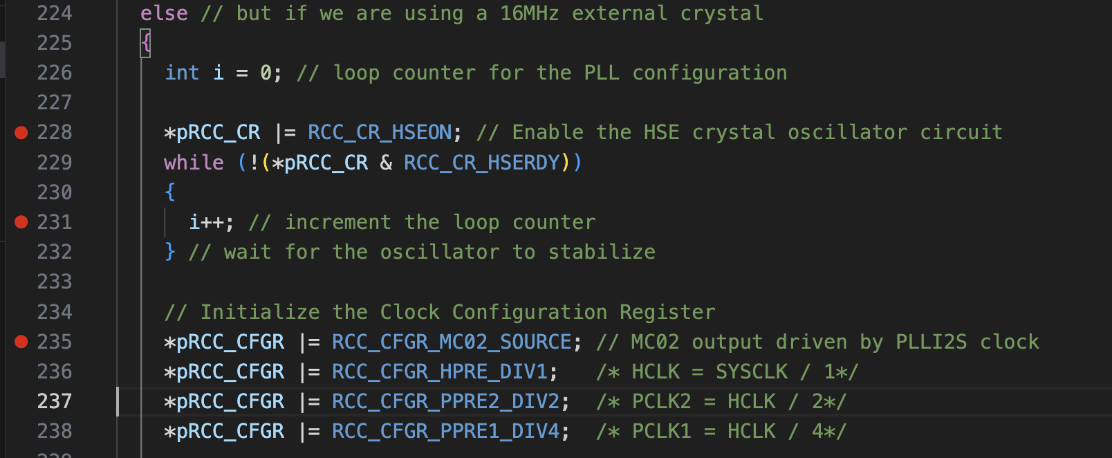

Curious about this, I made the following change and repeated the same test:
This time the code on line 231 never executed, and the infinite loop was gone. Apparently the crystal oscillator circuit was enabled before the while expression was evaluated (as it must have been previously since the indicator bit was set then also). But this time the while expression WAS evaluated, whereas it must not have been during the previous test.
And so this is exactly the kind of thing you advised me to be on the lookout for. What’s most disturbing to me is that the while expression would not be evaluated but the loop would be – that seems like a broken optimization to me.
You would need to look at the generated assembly to see if the compiler didn’t sneak in a read instruction before (or skipped it entirely) after it bitwise-ORed it with RCC_CR_HSEON.
Since *pRCC_CR |= RCC_CR_HSEON; involves
  1. loading the current value of *pRCC_CR from the pointer
  2. ORing a constant onto it
  3. writing back the new value to the pointer
the next !(*pRCC_CR & RCC_CR_HSERDY)) technically does not need to re-read the value from the pointer: We just read it and know its value because we just wrote it out again. The compiler can very aggresively optimize it out, and legaly so, due to the way the pointer is declared.
This is what happens when the pointer is not marked with volatile.
But really, I would not expend much time and energy looking how the compiler translated broken code on different optimization levels. It needs to be fixed.
