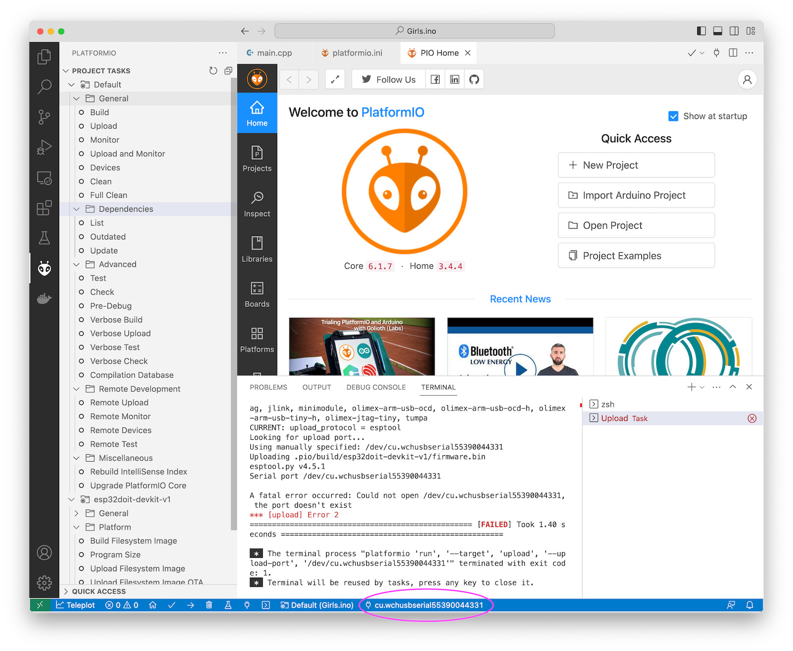

When I try to upload my program to an esp32 I have the following error:
Using manually specified: /dev/cu.wchusbserial55390044331
Uploading .pio/build/esp32doit-devkit-v1/firmware.bin
esptool.py v4.5.1
Serial port /dev/cu.wchusbserial55390044331
A fatal error occurred: Could not open /dev/cu.wchusbserial55390044331, the port doesn't exist
*** [upload] Error 2
=========================================== [FAILED] Took 2.18 seconds ===========================================
 *  The terminal process "platformio 'run', '--target', 'upload', '--upload-port', '/dev/cu.wchusbserial55390044331'" terminated with exit code: 1.
The strange thing is i do NOT have manually specified anything…

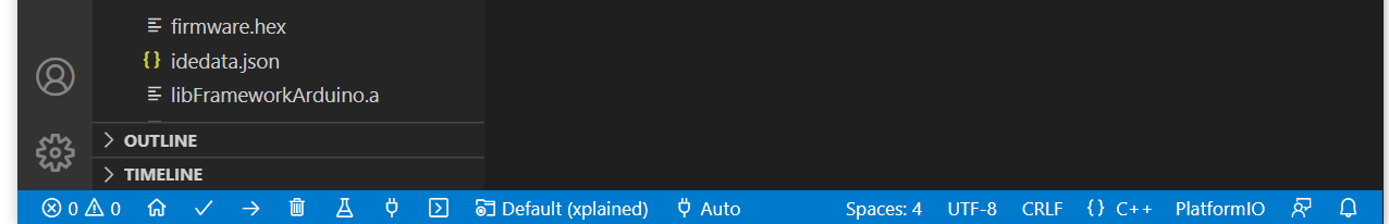

Are you sure you
  1. have selected the project and environment through the project environment switcher?
  2. do not have a serial port manually set through the taskbar? (“Auto”)
Hello !
Indeed, you’re right !
There was a specific port defined (forced) in the task bar.
I was not even aware of this possibility !
(I don’t know how I can have clicked here and there to get this result !)
I should have posted a screenshot too.
I was focussing on the content of the platformIO.ini content…
