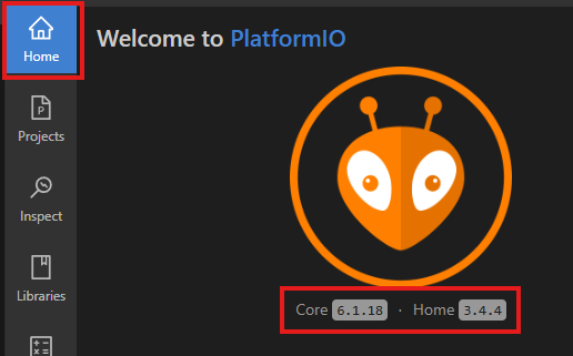

What are the versions of
  • VS-Code
  • PlatformIO Core
  • PlatformIO Home
Obtain VS Code version: menubar “Help” / “About”
Obtain PIO versions: PIO-Home
