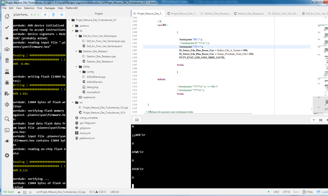

 First of all, my whole project is constitued of 6 files...
 Next, I hope to be able to show you with screenshots the strange behavior of my application.
 On this first picture, we can see that all is working well !!!
 The case 902 and default are not invoqued…
In this second picture and step, I have uncomment the line 1402 and we can see in the stdio output there is some strange caracters….
In this third picture and step, I have comment the line 1402, uncomment the line 1414 and we can see in the stdio output there is some strange caracters….
In this fourth picture and step, I have comment the line 1402, comment the line 1414, uncomment the line 1401 and we can see that all is working well !!!
I can post only one picture, I can send the 4 pictures in 4 reply or by email if you want…
My interpretation of that is when we want to use a lot of time Serial.print function, there is a problem in the memory manage…
Tell me if you some more informations…. I want to participate a maximum to solve this problem….
Thank fo advanced for your help !!!
