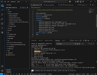

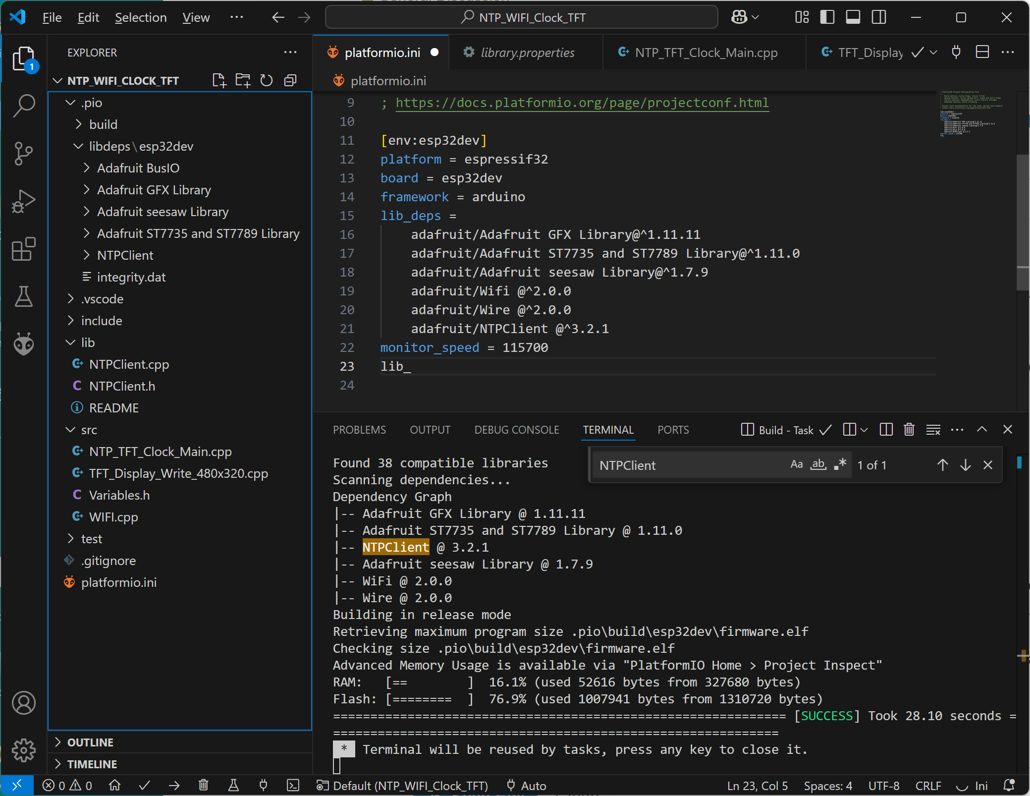

I just added a few libraries via the “lib dependency” route. The program compiles, and those dependencies are in the .pio\libdeps folder, but they are not in the platformio.ini file. In the picture below, I added the dependencies in the .ini file, and no change, it still compiles fine. I also tried to add a lib_extra_dirs to point to a “modified” NTPClient.h (contains a “date” function), but I just can’t that to work. It can’t find the file. Any pointers?
If you have a modified version of the NTPClient in library, don’t include it in the lib_deps expression in the platformio.ini. Remove it from there. When building, PlatformIO will look into the lib/ folder and find your modified library.
(Also delete the .pio folder of the project after removing it from lib_deps so that the old library is definitely gone).
That was part of the problem. You can see my modified NTPClient in my library, but when compiling, it could not find the file. I made sure the “extra” function was not called, and just installed the regular NTPClient.
