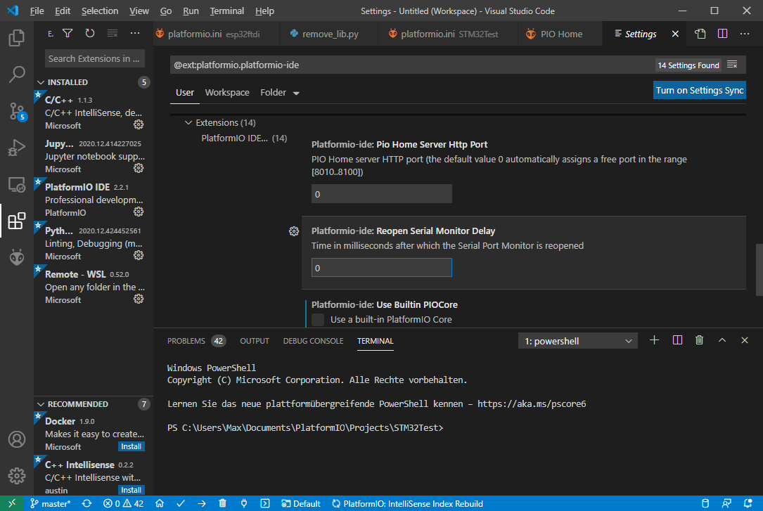

Are you using the “Upload and Monitor” task in the project tasks window? There shouldn’t be too much time between uploading and starting the serial monitor. If doing successive runs, PlatformIO will automatically close and re-open the serial monitor (with a configurable delay).
Note that depending on the target board you’re uploading to, PlatformIO needs to close / disconnect from the serial monitor since the firmware is uploaded through the serial connection, so “keeping it open” is not possible - just disconnecting and connecting at the right time to not interfere with the upload.

The “Terminal” tab just has all the different terminal sessions that can be switched to, but I couldn’t find a way to detach it to a new screen. Just resizing and splitting the terminal in two is possible.
Depending on the target MCU I’d recommend to
  • add a small delay() in setup to help PlatformIO catch up
  • if using an MCU which creates the USB-CDC, while(!Serial) {} is an often possible way to wait until the serial connection is established
  • usage of just the “Upload” task and using an external serial monitor program, e.g. HTerm - der-hammer, PuTTY or TeraTerm. Note that you will need to disconnect before uploading though if upload happens over the same serial port
