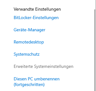

The folder in which this gcc executable resides must now be added to the PATH. To do this, right click on “This computer” in the Windows explorer window and go to the last item “Properties”.
A window will open that, if wide enough, reveals “Advanced System settings” on the right side.

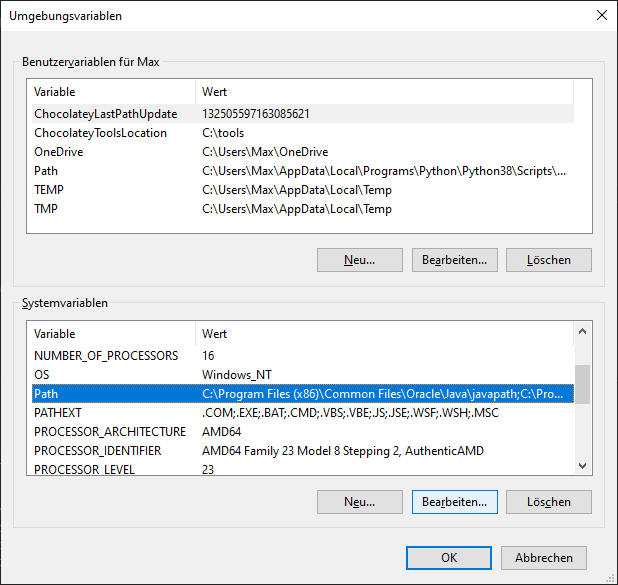

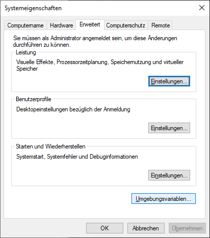

In there, click the button “Environment variables”.
grafik
Edit the “PATH” variable in System variables, not the user variables.
Use the “New” button to the folder in which gcc resides to the system’s PATH environment variables.
Press “OK” on all dialogs until everythings closed.

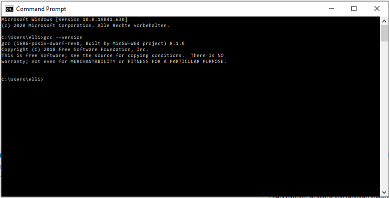

Restart your computer. Then, open a Windows terminal (Windows + R → cmd.exe) and execute gcc --version. It should output something like
gcc (x86_64-posix-seh-rev0, Built by MinGW-W64 project) 8.1.0
Copyright (C) 2018 Free Software Foundation, Inc.
This is free software; see the source for copying conditions.  There is NO
warranty; not even for MERCHANTABILITY or FITNESS FOR A PARTICULAR PURPOSE.
If not, you have not added the correct path to the PATH variable.
If all is good, re-open VSCode with the Marlin project and try to re-initialize the project again. Does it work now?

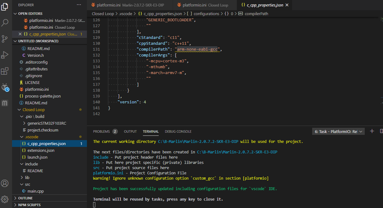

Then I have cleaned up VSCode and started from scratch. After finishing and cbuilding with pio - Error: “CC” written wrong or could not be found.
Then I edited the path for gcc in platformio.ini and error again - but different!
See the screenshot and the build -messages:

The PlatformIO Rebuild IntelliSense project task has to do that. I see per your last picture that that actually executed successfully now. Has it adapted the c_cpp_properties.json accordingly with the full path to your compiler? As said, it should be something like C:\Users\elli\.platformio\packages\toolchain-gccarmnoneeabi\bin\arm-none-eabi-gcc.exe.

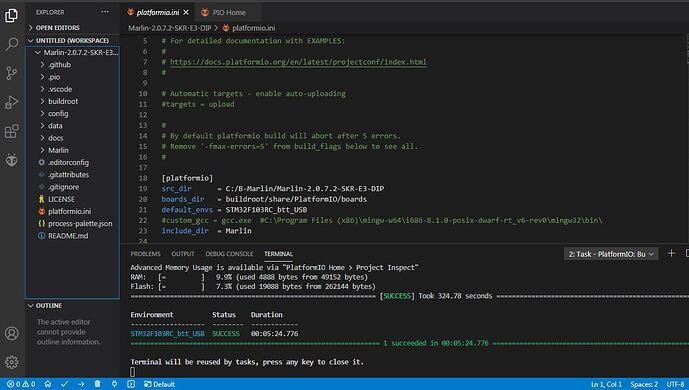

Does Marlin build now with the build button?
In the …json file it does not show the path:
Yes - Marlin now works perfect with the button (whenever the Alien is finished…)
I’m baffled on why there is still no full path in there.

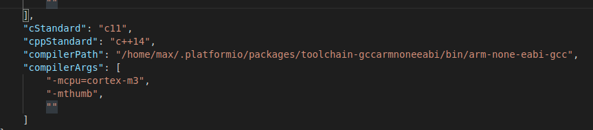

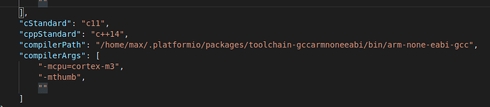

I’m testing this on Linux (but behavior should be the same) and when I do a normal PlatformIO project I get
the full path.
You did upgrade your core to the very latest version with pio upgrade --dev in the PlatformIO CLI right?
I’ll also try with the Marlin project shortly…
Edit: With Marlin it also works perfectly fine, full path given
and IntelliSense working

        "cppStandard": "c++14",
        "compilerPath": "arm-none-eabi-gcc",

For the life of me I can’t figure out why PlatformIO won’t put the full path to the compiler in there. Will have to retest on Marlin later today…

Hi Max,
now here we have the salad!,
Just for fun I thought it would be an idea to put all the stuff onto my old Win-7 laptop!
I installed it - took the new 2.0.7.2 version from BTT, went through your recipe-setup (…pio upgrade…),
no system-path at all, no special treatment - and it compiled successfully!
There are some warnings - but produced the firmware.bin!
you can see the screenshot and the partial terminal-output (…warnings) :blush:

All I need to check, if this is a one-time-event, or if it is reproduceable!
I will let you know after my sleep!
Regards
Hans
It seems, it works continuesly! The second run even without error-messages!
