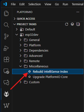

Please perform a rebuild of the IntelliSense Index:
Also cleaning the project might help:
Thank you I will try, no Rebuild under Miscellaneous.

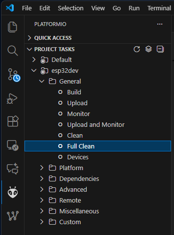

Then you did something wrong or your project was not setup correctly. A clean wipes previously compiled files.
You should find it on project tasks / <env-name>/ Miscellaneous
Thank you, clean works fine I had the problem with full clean
A full clean also deletes the downloaded libraries located in the .pio/build/libdeps directory of the project.
However, since the libraries are specified in platformio.ini under lib_deps, they will be downloaded again during the next build automatically. There should no further errors occur after a full clean.
