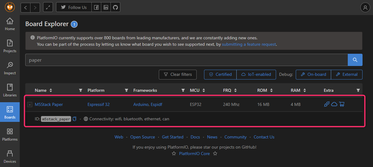

Today I noticed that the M5Stack Paper board (ID: m5stack_paper) can no longer be found in the docs. I can still find it in my Board Explorer, but the link shows “Page not found.”
Was this deleted intentionally, or did I overlook something?

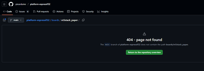

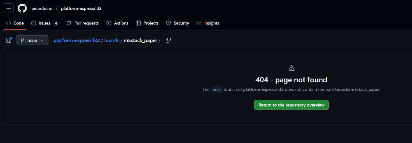

Do you use pioarduino’s Espressif32 Platform?
There is a board manifest for m5stack-paper.json
PlatformIO probably never had this board manifest ?! (See platform-espressif32/boards at develop · platformio/platform-espressif32 · GitHub)
In this case, there is no PlatformIO documentation for this board.
Something went wrong while pasting the link.
