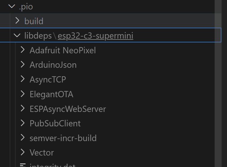

I’m getting a linker error after moving files around. I have this library installed, and it’s declared in the platformio.ini file.
I have tried:
  • Uninstalling the platformIO extension
  • deleting the .pio folder
  • deleting the %USERPROFILE%.platformio directory
Any suggestions? (let me know if you need more info - file layout etc)
In file included from lib/core/lib/CoreManager/CoreManager.cpp:13:
include/board_config.h:12:10: fatal error: Adafruit_NeoPixel.h: No such file or directory

If a library (“core”) can’t find its dependency (“Adafruit NeoPixel”), then the first thing you should try is testing all lib_ldf_mode values.
Spoke too soon - sorry, forgot I’d checked out master to see if the bug would follow me.
Tried all of them and the issue remains.
So you’re saying, even with
lib_ldf_mode = deep+
The “core” library doesn’t find the Neopixel library?
What’s the exact dependency graph when you do a verbose compile? (PIO CLIpio run -v -j1 -e esp32-c3-supermini)
I’ve no idea what the issue is, but I did a clean, deleted .pio and restarted vscode. Then built and we’re good again.
I’ve had this once or twice before - there seems to be a stale cache somewhere. If I ever work out the sequence to reliably repeat this then I’ll post it.
