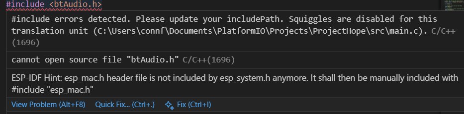

#include errors in vs-code using platformio w/ Esp32-c6
Hi there, I am hoping someone can help me out with this frustrating bug/issue or wrong configuration.
I’ve attached screenshots of the shown error, I’ve tried re-installing platformio and creating several new projects as well as restarting my device without any change. Also I’ve checked that the include path config is correct and it has the paths to were the lib deps should be.
I keep getting the #include error for libraries that I’ve added to the project using the platformio extension. Any help would be greatly appreciated as I’m completely stumped.

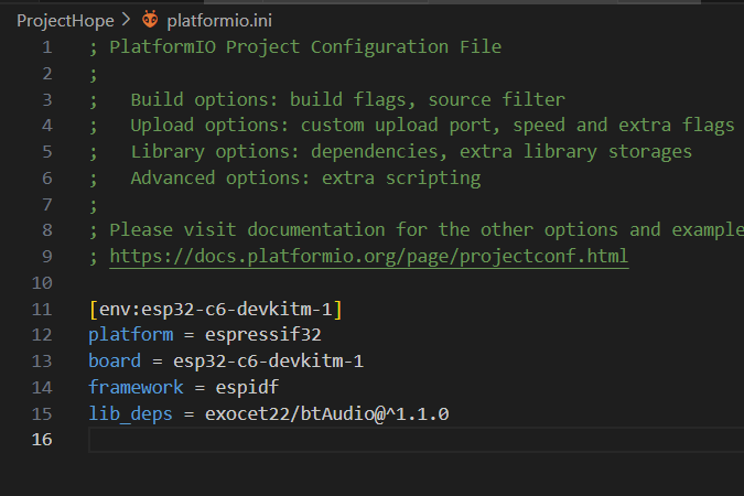

..What are you doing?
  1. The btAudio library is only framework = arduino compatible, not framework = espidf compatible per manifest
  2. Don’t use lib_deps with framework = espidf, use ESP-IDF components via idf_component.yml file instead (Readout KConfig from ESP-IDF libraries added via lib_deps, too · Issue #453 · platformio/platform-espressif32 · GitHub, How to get mDNS working with ESP-IDF v5 - #10 by peterl)

If you want only that btAudio library, can’t you use framework = arduino directly? Compiling ESP-IDF and Arduino on top just makes it more complicated.
it says not compatible with my board, (esp32-c6) when i try to compile
The ESP32C6 has only a BLE (bluetooth low energy) radio, no bluetooth classic (BTC) which is needed for A2DP. The btAudio library is indeed not compilable for the ESP32C6 because it expects the Bluedroid stack to be present that’s not there on the C6.

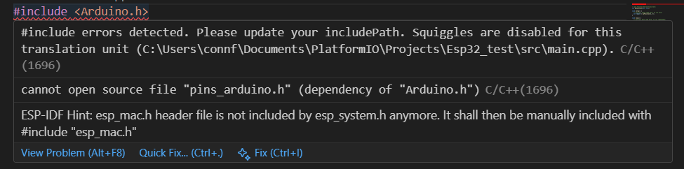

I just tried testing with a generic esp32 device and i still get the include error…

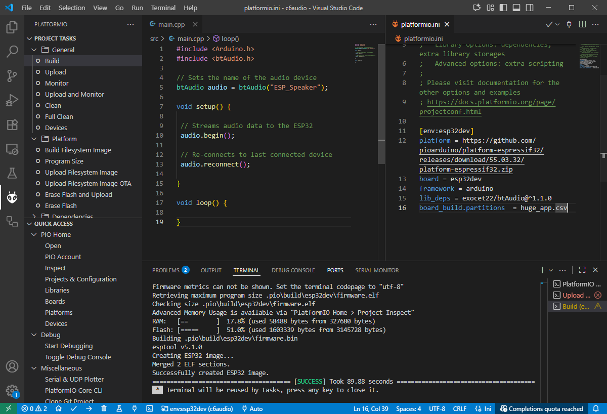

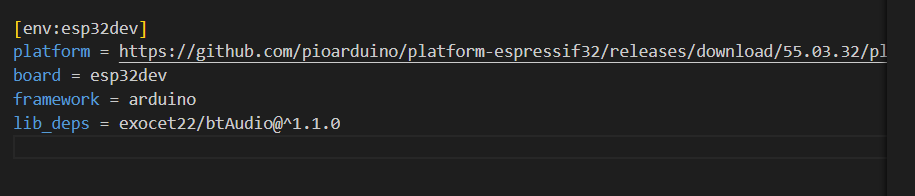

The https://github.com/Exocet22/btAudio/blob/master/examples/advertiseBluetooth/advertiseBluetooth.ino example compiles fine.
platform = https://github.com/pioarduino/platform-espressif32/releases/download/55.03.32/platform-espressif32.zip
lib_deps = exocet22/btAudio@^1.1.0
board_build.partitions  = huge_app.csv
You may have a corrupted package.
  1. Close VSCode
  2. Delete C:\Users\<user>\.platformio\packages
  3. Delete C:\Users\<user>\.platformio\platforms
  4. Delete C:\Users\<user>\.platformio\.cache
  5. Restart VSCode
  6. Wait for everything to reinitialize and redownload
  7. Hit “Build” again.
That seems to have worked for now, :smiley:
Many thanks!! I’ll update this thread in case it bugs out again.
