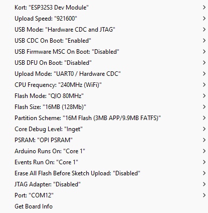

Here is my working settings in the Arduino IDE, can you maybe see what I’m missing in platformio?
You also have to apply the extra settings (flash_mode, psram_type etc etc) I have mentioned above. Use the platformio.ini from my posting above.
I’ve noticed USB Mode: "Hardware CDC and JTAG" and USB CDC On Boot: "Enabled" in your ArduinoIDE settings so i added this to the platformio.ini as well.

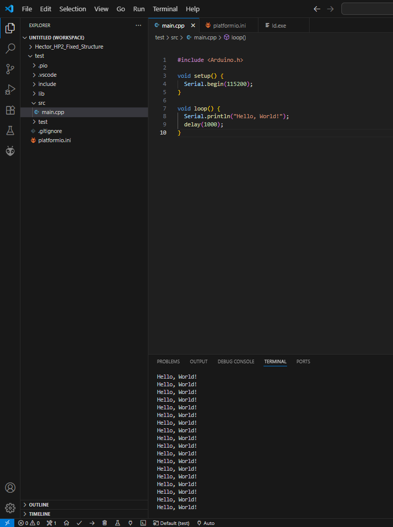

Does a simple Blink or “Hello World” sketch work?
platformio.ini
[env:esp32-s3-devkitc-1]
platform = espressif32 @ 6.11.0
board = esp32-s3-devkitc-1
board_build.arduino.memory_type = qio_opi
board_build.flash_mode = qio
board_build.psram_type = opi
board_upload.flash_size = 16MB
board_upload.maximum_size = 16777216
board_build.partitions = default_16MB.csv
board_build.extra_flags =
  -DARDUINO_USB_CDC_ON_BOOT=1
  -DARDUINO_USB_MODE=1
  -DBOARD_HAS_PSRAM
main.cpp
  Serial.println("Hello, World!");
  delay(1000);
Sure thing. So thank you for the help with compiling/uploading to the T-deck. Your settings are totally right. There is just something in my code that does not compile correctly / or the same as in Arduino IDE. Hm…

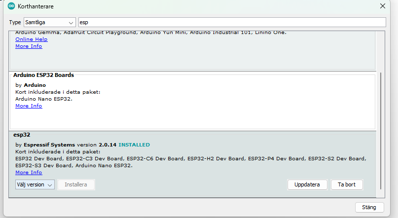

So, I just remembered I had an issue in the Arduino IDE when first beginning to code the T-deck. The library for the screen, TFT_eSPI, is not compatible with ESP32 boardmanager above 2.0.14. Having a higher version gave the same problem, the T-deck constantly rebooting. So I need to downgrade PIO just like I did in board manager in Arduino IDE. Not sure how though. More about this here
To get Espressif Arduino Core 2.0.14 you have to change the platform setting your platformio.ini:
platform = espressif32 @ 6.6.0
For more infos about the version numbers see platform-espressif32 versions · GitHub
