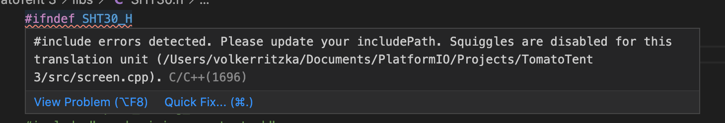

I am getting an error when using header guards.
For example
#ifndef SHT30_H
#define SHT30_H
Screenshot:
Does someone know why?
Thanks in advance!

Ctrl-shift-p then choose “rebuild intellisense”. Or just try a build. Those usually work.
The squiggles are from intellisense, not from PlatformIO.

Thanks, that works.
Just want to add, its command-shift-p on Macs
