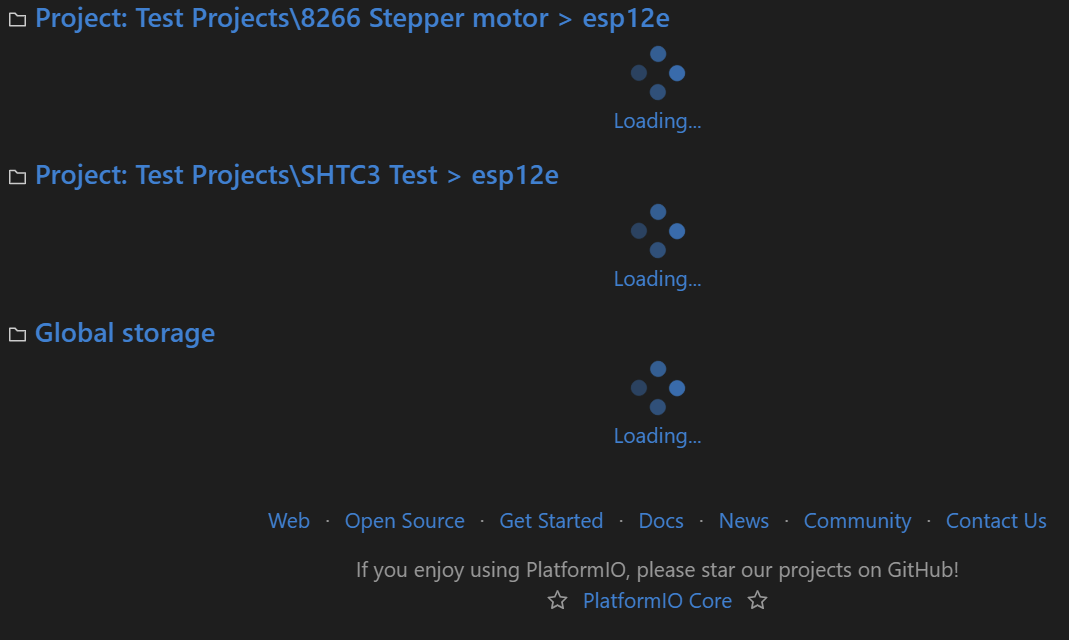

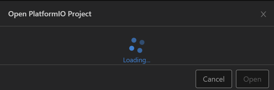

I am using a Windows 10 desktop with a standard BT Internet nothing fancy.But for the last week I been experiencing problems using any of the buttons like new project open project et cetera, or any of the recent news examples.All I get is a spinning circle:
The same thing happens when I am looking under libraries updates

Please open a PIO CLI terminal and execute pio upgrade --dev. Then restart VSCode. In the PIO home screen, is the core version now 5.0.4a2? Does your infinite-loading error persist?
Well again you seem to have solved the problem, just one thing when visual studio loads now Platformio alien face appears in the side bar
