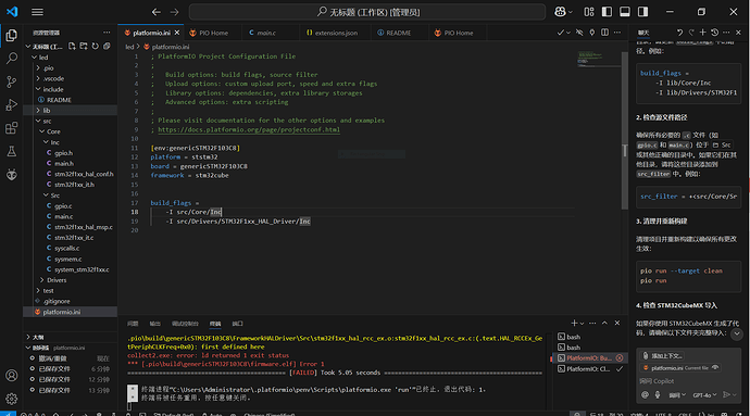

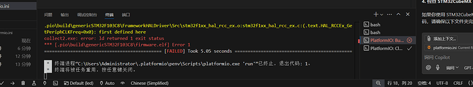

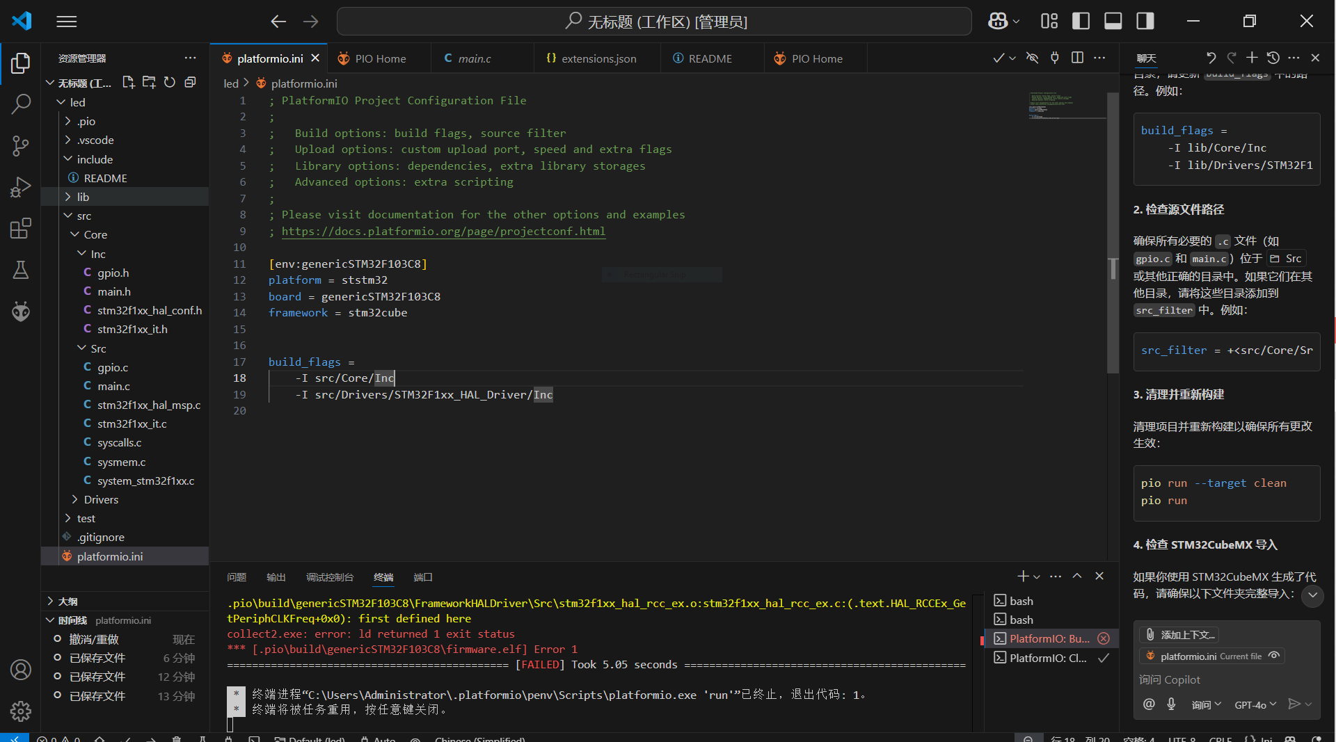

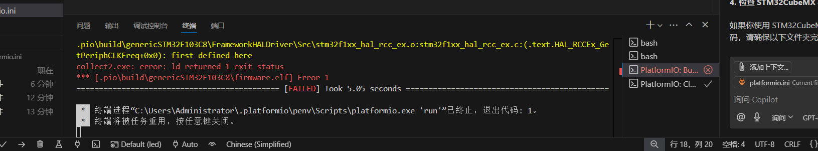

I have some problem when i compile the code,,plesese give me some sugestion

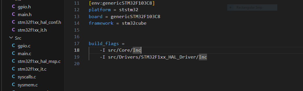

When you write
framework = stm32cube
Then, PlatformIO will already download and include the STM32HAL and compile it automatically into the project.
It seems that you have also copied src/Drivers into your project, which is again the HAL. Therefore, the HAL will be in there twice, leading to double definitions.
Either:
  • Delete src/Drivers
Or
  • Delete framework = stm32cube. (This will require you to also include the startup .S file and setting the linker script using board_build.ldscript = STM32F103C8_FLASH.ld (or similiar), so it’s more compilcated)

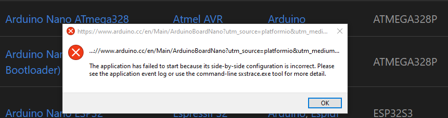

i can’t download boards , the problem
