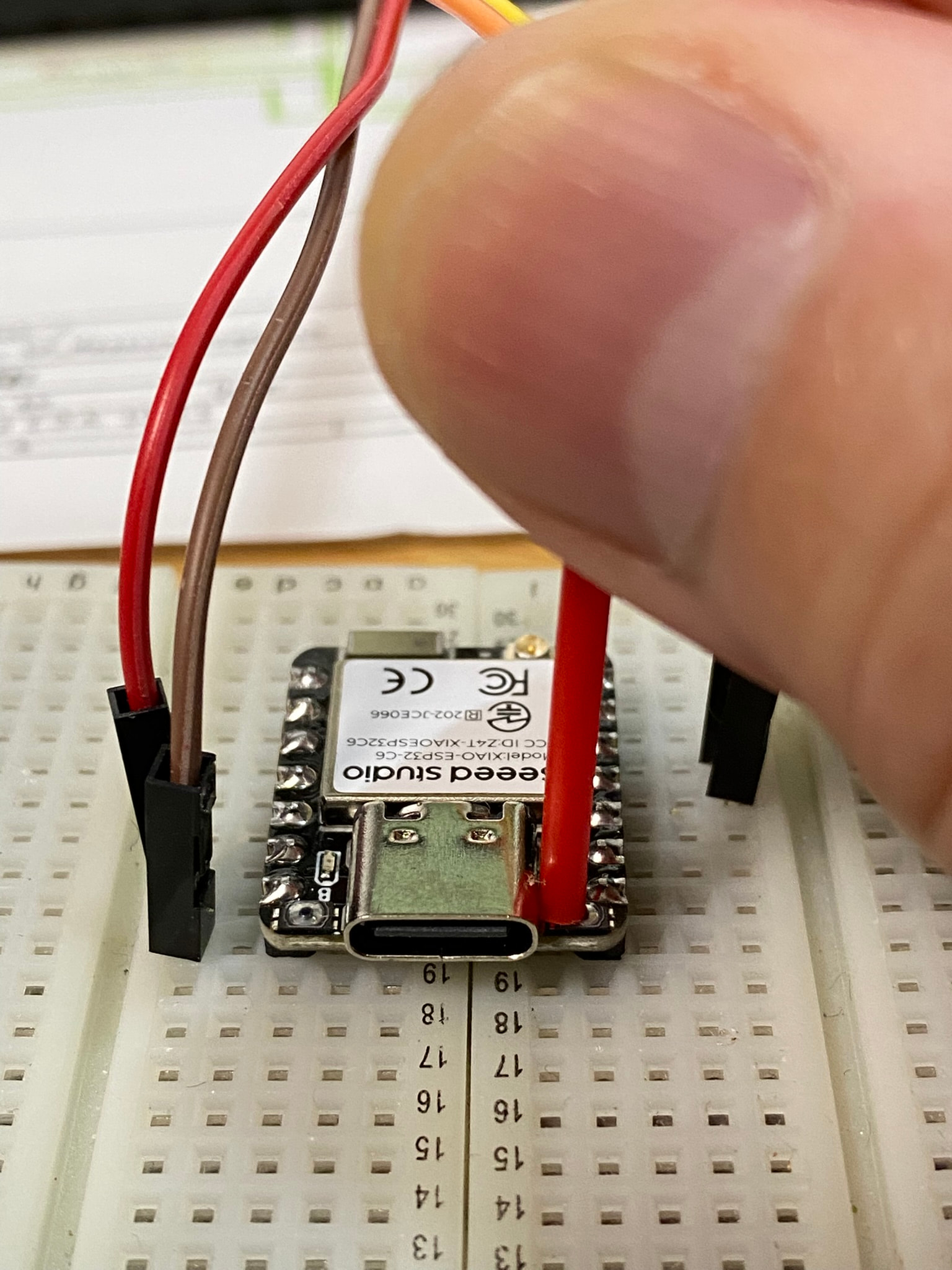

I use a spray can straw or a bamboo skewer.
Of course, after wiping it thoroughly. LOL

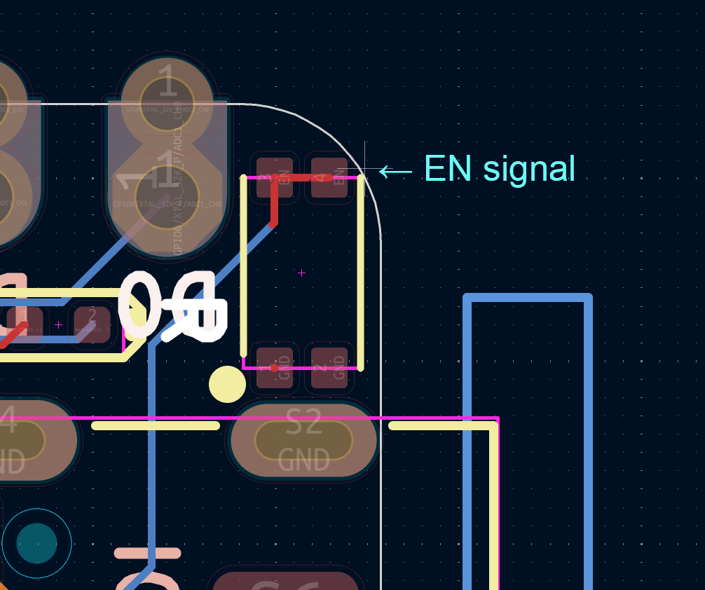

As you know, the XIAO-ESP32C6 does not have a reset signal terminal to access easily.
(The EN signal pad itself is located on the back of the circuit board, but connecting it is not easy.)
If you are handy and brave enough to modify the circuit board, I think it would be possible to run wires from both ends of this small reset switch and connect a larger switch. (Sorry, I haven’t done that myself.)
Fortunately, the EN signal is accessible from the RESET SW terminal, so you can solder a lead wire there and connect it to one of the momentary switch terminals.
The GND signal has its own dedicated terminal, so connect the other terminal of the momentary switch to GND.
