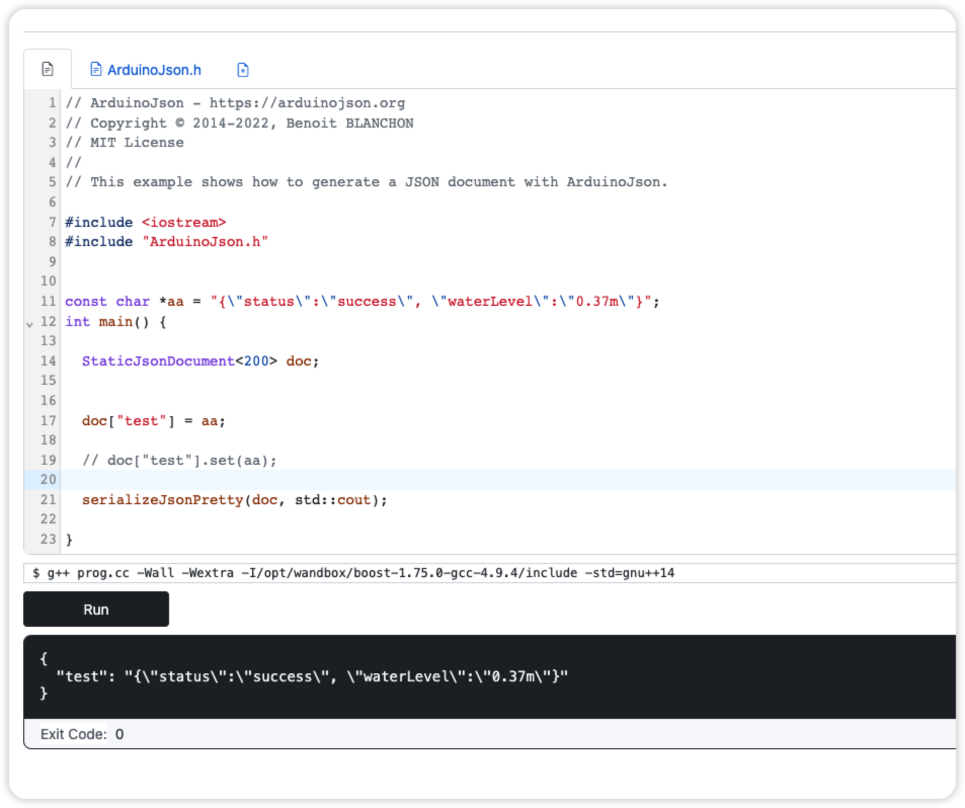

the picture’s two way are failed.
Can you parse the char* in a JSON document first and set that as a attribute?
DynamicJsonDocument doc2(1024);
deserializeJson(doc2, aa);
doc["test"] = doc2;
you are so brilliant,it can slove the problem, but I wonder there is the other good way,
I use your suggestion, thank you!!!
