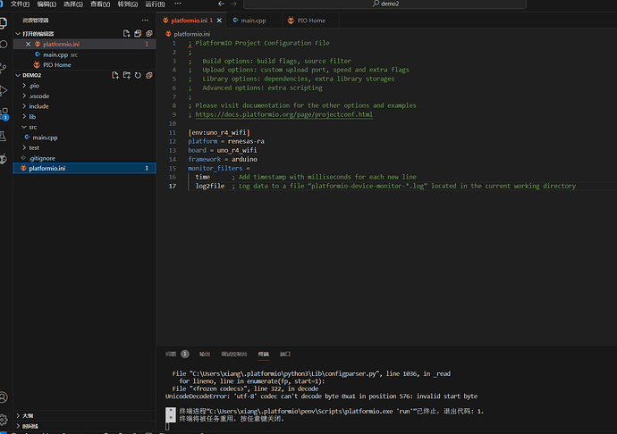

How do I save Arduino serial data to excel?
 *  正在执行任务: C:\Users\xiang\.platformio\penv\Scripts\platformio.exe run
Traceback (most recent call last):

UnicodeDecodeError: 'utf-8' codec can't decode byte 0xa1 in position 576: invalid start byte

    telemetry.log_exception(exc)
  File "C:\Users\xiang\.platformio\penv\Lib\site-packages\platformio\telemetry.py", line 276, in log_exception
    log_event("exception", params)
  File "C:\Users\xiang\.platformio\penv\Lib\site-packages\platformio\telemetry.py", line 168, in log_event
    TelemetryLogger().log_event(name, params, instant_sending=instant_sending)
  File "C:\Users\xiang\.platformio\penv\Lib\site-packages\platformio\util.py", line 132, in get_instance
    _instances[cls] = cls(*args, **kwargs)
  File "C:\Users\xiang\.platformio\penv\Lib\site-packages\platformio\telemetry.py", line 78, in __init__
    self._http_session = HTTPSession()
  File "C:\Users\xiang\.platformio\penv\Lib\site-packages\platformio\http.py", line 52, in __init__
    self.headers.update({"User-Agent": app.get_user_agent()})
  File "C:\Users\xiang\.platformio\penv\Lib\site-packages\platformio\app.py", line 277, in get_user_agent
    if not get_setting("enable_telemetry"):
  File "C:\Users\xiang\.platformio\penv\Lib\site-packages\platformio\app.py", line 208, in get_setting
    with State() as state:
  File "C:\Users\xiang\.platformio\penv\Lib\site-packages\platformio\app.py", line 88, in __init__
    self.path = resolve_state_path("core_dir", "appstate.json")
  File "C:\Users\xiang\.platformio\penv\Lib\site-packages\platformio\app.py", line 77, in resolve_state_path
    state_dir = ProjectConfig.get_instance().get("platformio", conf_option_dir)
  File "C:\Users\xiang\.platformio\penv\Lib\site-packages\platformio\project\config.py", line 489, in get_instance
    instance = {"mtime": mtime, "config": ProjectConfig(path)}
  File "C:\Users\xiang\.platformio\penv\Lib\site-packages\platformio\project\config.py", line 87, in __init__
    self.read(path, parse_extra)
  File "C:\Users\xiang\.platformio\penv\Lib\site-packages\platformio\project\config.py", line 99, in read
    self._parser.read(path, "utf-8")
  File "C:\Users\xiang\.platformio\python3\Lib\configparser.py", line 713, in read
    self._read(fp, filename)
  File "C:\Users\xiang\.platformio\python3\Lib\configparser.py", line 1036, in _read
    for lineno, line in enumerate(fp, start=1):
  File "<frozen codecs>", line 322, in decode
Exception ignored in atexit callback: <function _finalize at 0x0000022E890DFD80>
  File "C:\Users\xiang\.platformio\penv\Lib\site-packages\platformio\telemetry.py", line 313, in _finalize
    telemetry = TelemetryLogger()
 *  终端进程“C:\Users\xiang\.platformio\penv\Scripts\platformio.exe 'run'”已终止,退出代码: 1。
 *  终端将被任务重用,按任意键关闭。
	"resource": "/e:/Wenzhou University/Temporary working folder/Project/EXperiment2(piezoelectric)/demo2/platformio.ini",
	"owner": "PlatformIO",
	"severity": 8,
	"message": "'utf-8' codec can't decode byte 0xa1 in position 576: invalid start byte",
	"startLineNumber": 1,
	"startColumn": 1,
	"endLineNumber": 1,
	"endColumn": 1
Ah. There was some fancy characters copied, I think. Try with just
monitor_filters =
  time
  log2file
