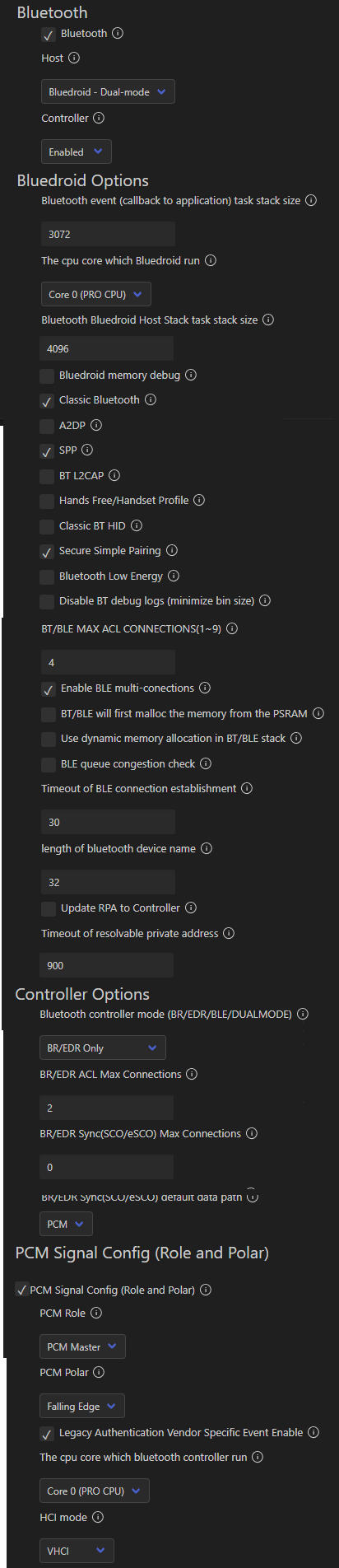

I tried with this configuration:
And also tried with HCI instead of PCM
