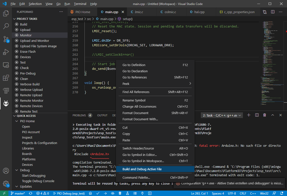

I don’t get a “Run Code” option when I right-click in my Window, but “Build and Debug Active File”
Maybe you have some extension installed which makes this option appear? In any case, your logs hows that it attempts to invoke the system’s GCC compiler which is wrong. It doesn’t know anything about the PlatformIO build system and attempts to build it itself, which it can’t.
The build and upload process must be triggered through the buttons from the PlatformIO extension, not the menu you have. If you need to ‘run’ the code you need to execute ‘Upload’ to push the code to the microcontroller for it to run it.
The build log shows already that your PlatformIO installation was able to successfully compile the project, so there isn’t actually a problem :sweat_smile:.
This is what i get when i use the Build and debug option.
