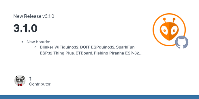

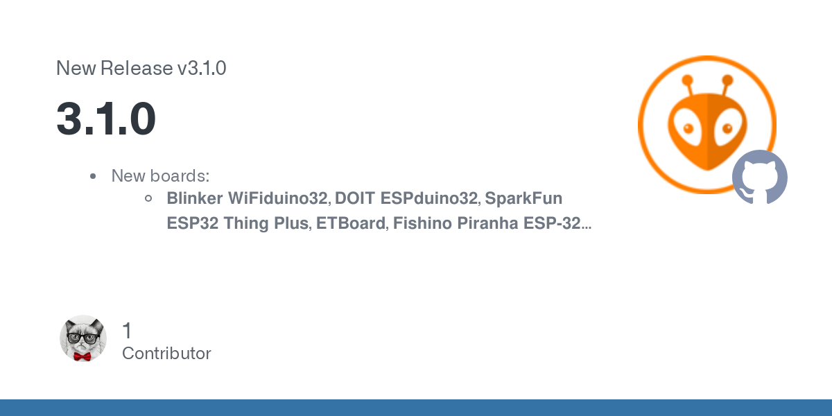

Since I compiled that code on the first of March 2021 I must have used Espressif 32 v3.1.0 + Arduino 1.0.5:
I don’t remember uninstalling that version of the framework but now when I tried to install it again by using:
[env:esp32cam]
platform = espressif32 @ 3.1.0
board = esp32cam
I got error:
