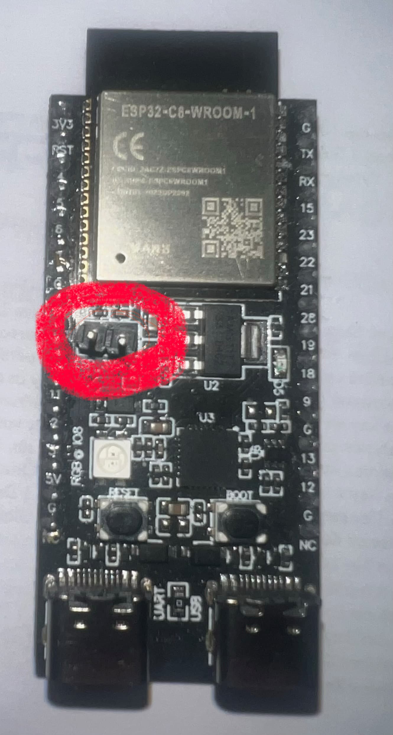

Ok I find my trouble. My board (ESP-C6-Devkitc-1 V1.2), buy on Ali,need an jumper to connect the UART usb-c connection part to communicate with the ESP-32 himself.
I solder too pins in the empty hole an put an jumper and it’s done the download work.
I hope the tip are usefull.

This jumper is not used to configure UART USB-C. However, it can be used to measure current. See
If it is not closed, no current can flow → The circuit board is not supplied with power and does not even work.
Conclusion : without it doesn’t work, with it’s work :slight_smile: and it’s sell without !
Odd. The doc clearly says the jumper is default installed: “Apply the jumper (factory default): Restore the board’s normal functionality.”
I’m exceedingly skeptical that removing that jumper will result in “Resource busy: ‘/dev/cu.usbserial” that’s described ITT.
This AliExpress version : ESP32-C6-DevKitC-1 wifi bluetooth entwicklung board core board cp2102 onboard ESP32-C6-DevKitC-1-N8 modul TYPE-C schnitts telle - AliExpress 502
have no pin and no jumper by default.
I you try to download without jumper you have this error :
”Serial port /dev/cu.usbserial-0001:
Connecting…
A fatal error occurred: Failed to connect to ESP32-C6: No serial data received.
For troubleshooting steps visit: Troubleshooting - ESP32 - — esptool latest documentation
Failed uploading: uploading error: exit status 2”
