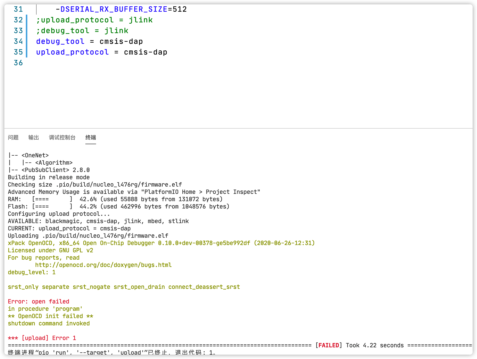

Can not upload program with DAPLink?
as the picture, When I use the jlink it’s good, but daplink is failure?
Is there anybody can help me? emmmm
Do you have a link to the CMSIS-DAP device that you bought and connected to your PC?
Also I assume you’re using Linux? What does dmesg -w output when you unplug and re-plug the CMSIS-DAP device?
I use it under the macos, and I can see it in the device tree.

Can you show a screenshot of the device tree? And again

Thank you,I use the platformIO in my project develop, do not use the evl kit, So I use the jlink or dap to download the program, with out stlink in my board!
