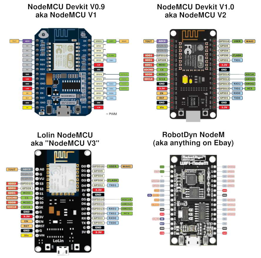

The boards with CP2102 are the same as NodeMCU V2 and the boards with CH340 are the same as NodeMCU V3 in this picture:
