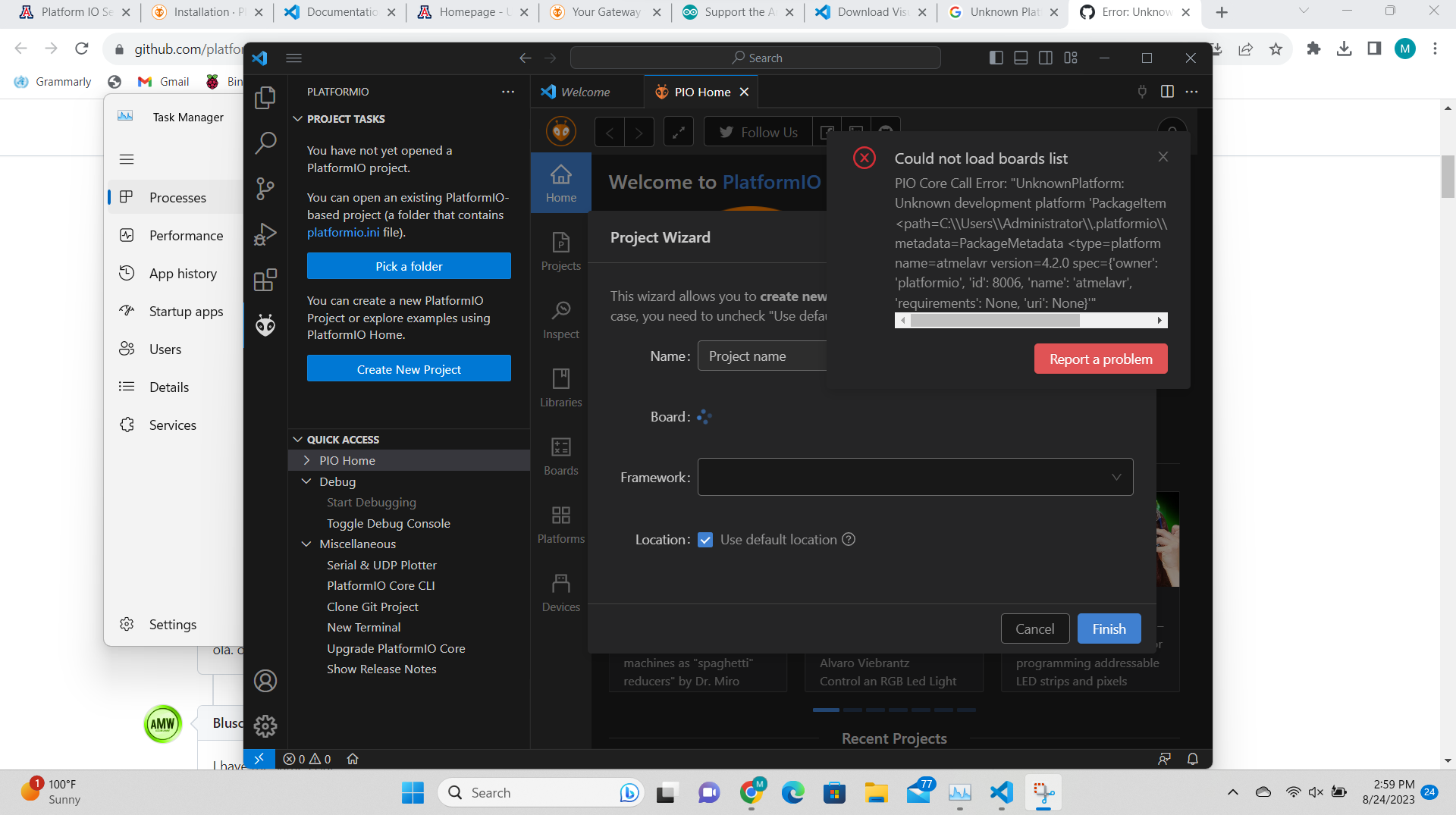

One of the students installed Platform IO but it will not recognize the board explorer. Here is a screenshot of the error:
We found the solution by deleting the .platformio file in the users folder and then re-opening platform io. Not sure why this worked but it was one of the solutions from a google search.
