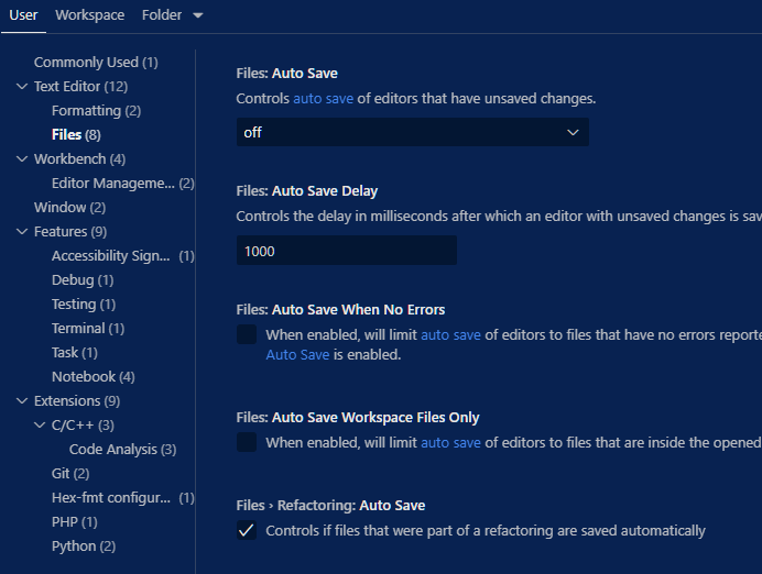

I don’t think that will do anything though so check the files.autoSave setting to see if that’s causing it.
Thanks RJ. I did autosave off and that stopped the messages. After fixing that issue a new one cropped up. Every time I compiled the “Rebuilding Intellisense index” message popped. This was annoying since it shifted the focus from Terminal to Output.

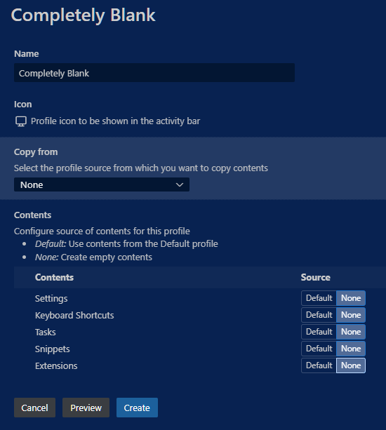

Another thing you can do to track down settings problem is to use “Profiles” to create a new profile that’s completely blank:
That gives you a profile with all settings, extensions, etc all completely wiped so everything should be vscode default.
Then install whatever extension is acting up in the blank profile, see if it’s still acting up, then reintroduce more extensions, settings, or whatever bit by bit until the problem starts happening again. (Only problem is if you marked any settings as “apply to all profiles” then it won’t be completely blank and you’d have to possibly remove things from workbench.settings.applyToAllProfiles.)
Editing settings in the text editor as JSON also helps because only things you’ve changed from the default should be listed if you’re looking at user settings. Similar with Workspace or Folder settings.
