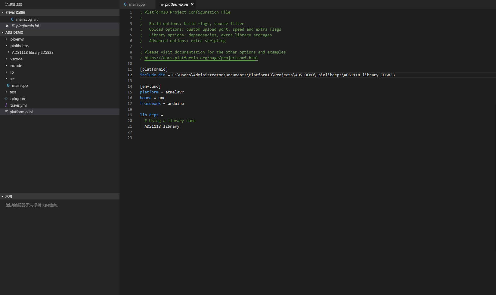

I downloaded an ADS1118 library from PlatFormio, compiled his example, and failed to compile. I do not know why. My hardware is arduino uno
Please post full platformio.ini
and the code you’re trying to compile.
Please remove [platformio]
section at all. No need to do include_dir.
OK Thank you for your answer ~~

Did not solve the problem, I created a new project and then modified the platformio.ini file to add the library file, then compile, and then an error, the IDE told me that he did not find the header file, I used include_dir and then no problem, but the compiler still Fail。

I had to put build_flags = -I ".piolibdeps/ADS1118 library_ID5833"
in my platformio.ini
to make this go away… for some reason platformio just isn’t matching this library at all.
